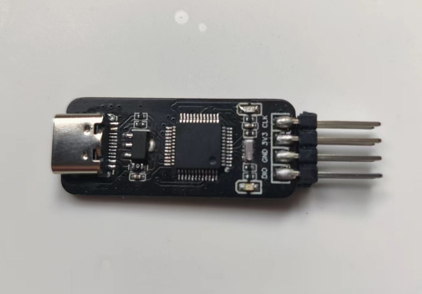

STM32F103CBT6 can be replaced by AIR32F103CBT6. Currently AIR32 is very cheap as long as 4.8, and st-link firmware can also be used directly.
