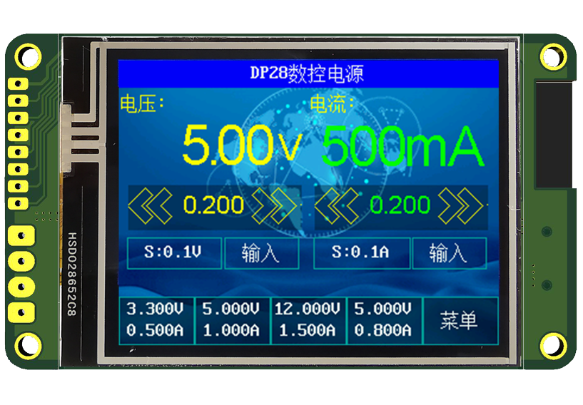

The DP28 CNC power supply is a continuation of the design ideas of the DP50 CNC power supply, and is a CNC power supply example produced with the shmictrl smart screen. Although this CNC power supply is positioned in the DIY market, the screen source code and the source code of stm32f072 are all developed, which means that this solution is used The screen end and control end (stm32 implementation), combined with various back-end implementations, can fully achieve the purpose of rapid development of various commercial power supplies;

The microcontroller part is very simple. It is a standard stm32 minimum system. Most of the IO is not used. Only GPIO is used. describe illustrate
PA4 DACV Voltage DAC output
PA5 DACI Current DAC output
PA6 ADV AD acquisition of voltage
PA7 ADI AD acquisition of current
PA8 3R33EN 3R33 shutdown control
Note: PA11 PA12 is reserved and not used here.
