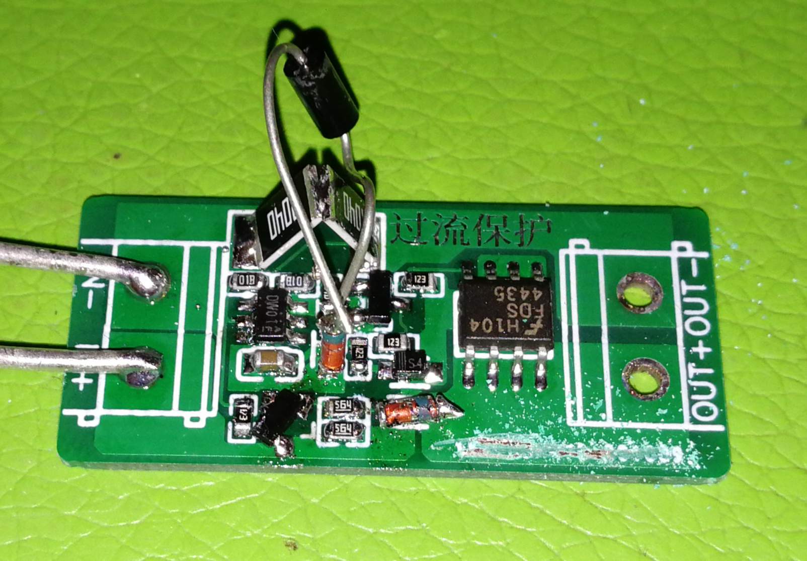

Output short circuit protection circuit
Implementation function:
When the load is short-circuited or exceeds the set overcurrent value, the output stops and is locked.
How to remove protection:
Remove the load, or reload the input power (provided the load is not overcurrent)
At present, the adjustable power supply has been tested to 16v for protection, and the actual battery should be able to reach 24v.
