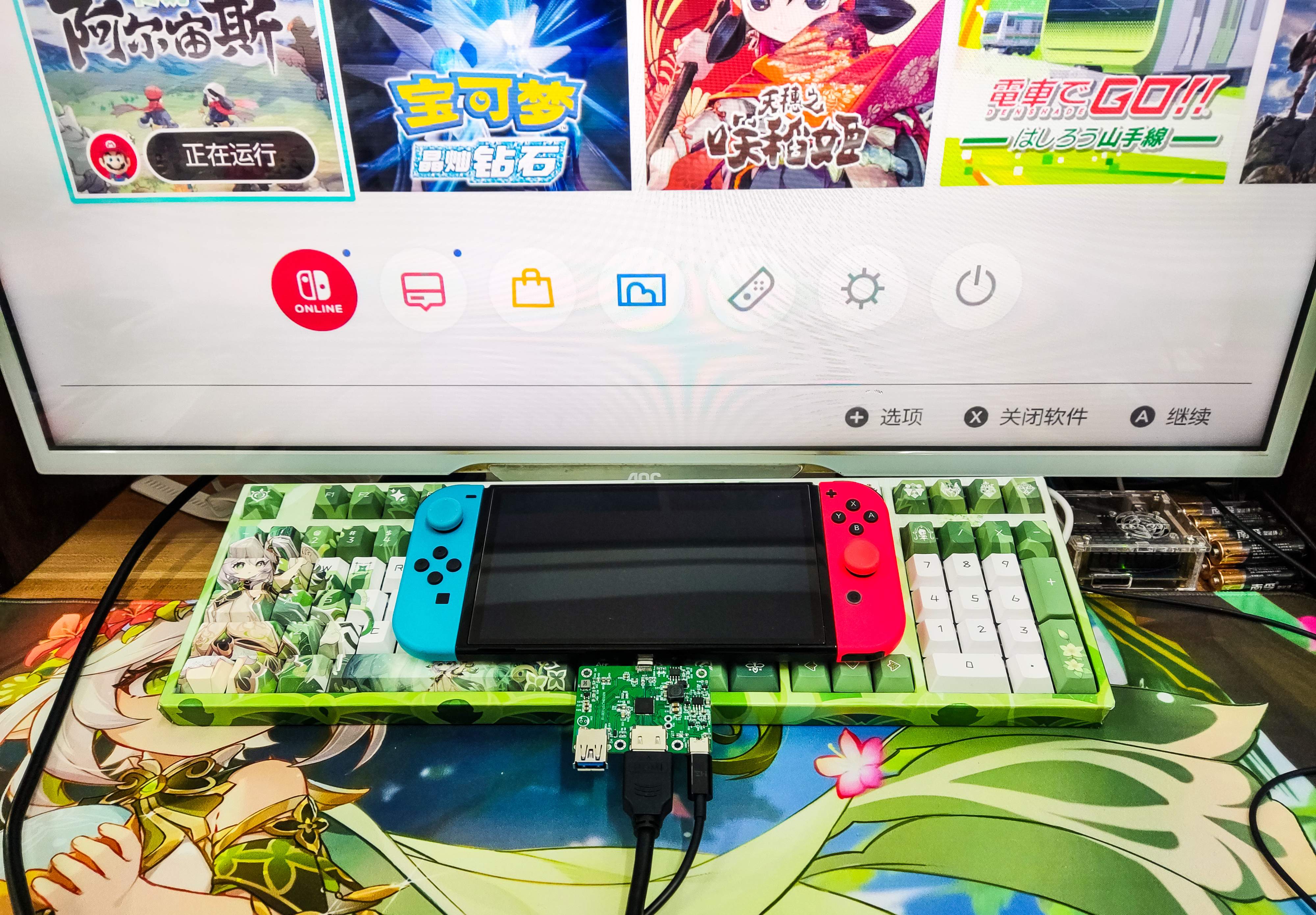

3. It
is compatible with Nintendo SWITCH (OLED version)
15V fast charge + HDMI output
Most Windows laptops
20V fast charge + HDMI output + USB3 transmission
USB3 transmission is measured, and the hard disk limit is not too high.

6. Actual test video
