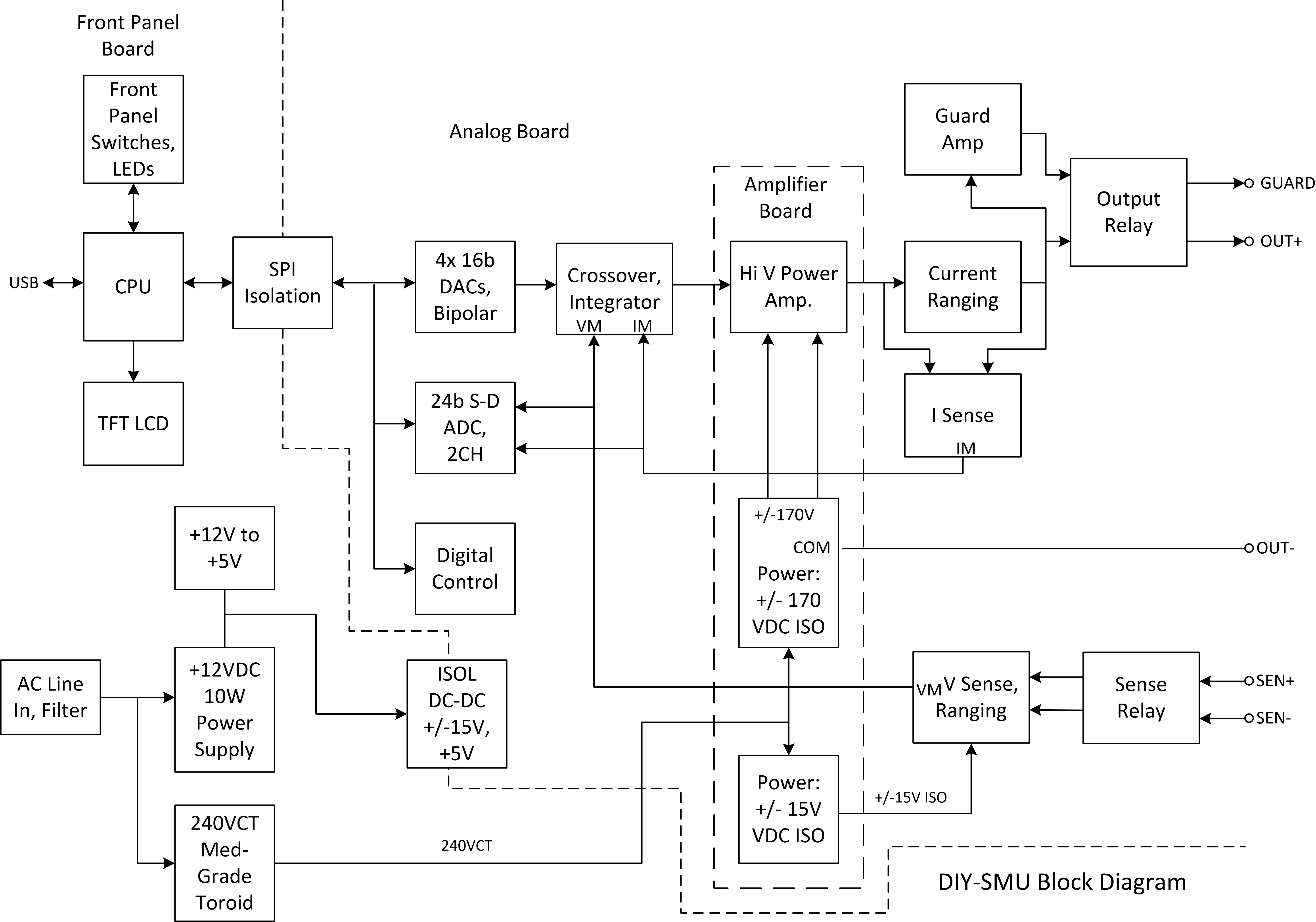

The SMU is a precision power supply device that can measure not only high-resolution voltage sources but also high-resolution current sources. It also integrates bipolar voltage and four-quadrant output functions to facilitate testing of various characteristics. By providing a linear sweep voltage and sweep current, the IV characteristic curve of the instrument can be obtained.
Specifications:
1. Voltage source and measurement support ±1.5V, ±15V and ±150V.
2. Current source and measurement support 1uA - 100mA
3. True four quadrants.
4. Output source accuracy 0.01%
5. Measurement accuracy 0.05%
Blockdiagram
