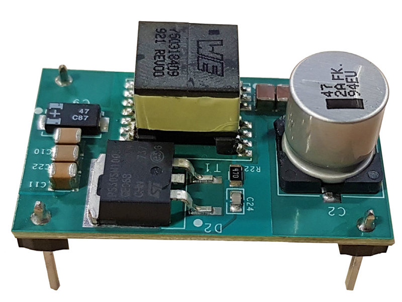

The MAXREFDES1247 is a miniature, 12V output, isolated power supply that can deliver up to 1A of load current. The design uses the MAX17596 peak-currentmode controller in discontinuous-conduction mode (DCM) flyback topology running at 125kHz. The input voltage range of the MAX17596 is 4.5V to 36V. However, an extra bias winding from the transformer is used to power the controller. This allows the input operating voltage to go up to 60V for this design.
The transformer provides a galvanic isolation of 1500VRMS between the primary and the secondary. In addition, an optocoupler is used to provide secondary-side feedback to the controller for voltage regulation while maintaining isolation. This document also discusses a step-by-step procedure to implement this reference design and presents design equations for the calculation of all the design parameters. These equations show how to calculate the component values to allow users to modify this design for their applications.
特征
Miniature Design Optimized for Small Size
17V to 60V Input Range
Isolated Output of 12V DC at 12W
Cycle-by-Cycle Current Limit
Resistor-Programmable UVLO/OVI Threshold
Low-Cost DCM Flyback Design
Galvanic Isolation Up to 1500VRMS
Proven PCB Layout
Fully Assembled and Tested
