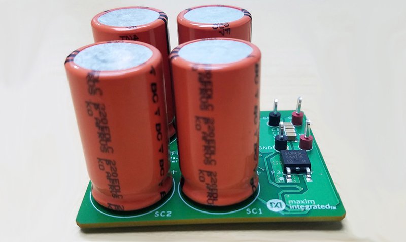

This document introduces the reference design shown in Figure 1 and provides detailed technical guidance for designing supercapacitor charging and dv/dt compensation circuits. The circuit has been built and tested, please refer to this document for details.
