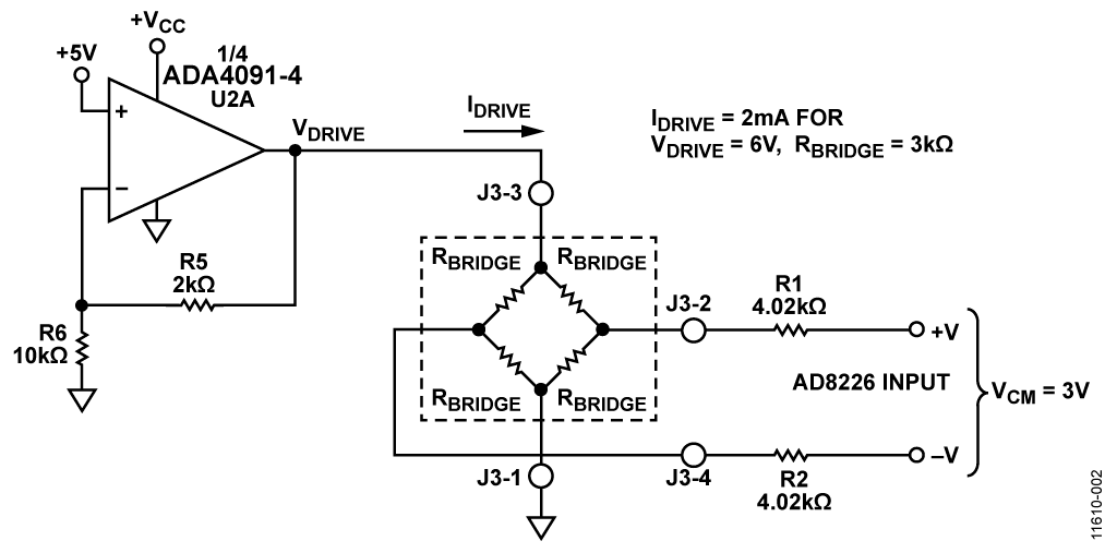

Excitation: Voltage Drive Configuration
Either voltage drive or current drive is required, depending on the pressure sensor selected. This circuit uses a quarter of an ADA4091-4 (U2A) and supports one of two options with different configurations selected via switch S1. Figure 2 shows the voltage drive configuration, with S1 positioned closest to the identification mark (see the complete circuit layout and schematic in the CN0295 Design Support package: http://www.analog.com/CN0295-DesignSupport . Voltage drive typically uses the gain of this stage (1 + R5/R6) configured for a 6 V bridge drive voltage. Other drive voltages can be obtained by appropriately changing the resistor ratio:
CN0295_Image1
Note that the supply voltage V CC should be at least 0.2 V higher than the bridge drive voltage so that U2A has sufficient headroom. ADA4091-4:
CN0295_Image2
CN0295_Image3
The ADA4091-4 op amp was chosen for this circuit because of its low power consumption (250 μA per amplifier), low offset voltage (250 μV), and rail-to-rail input and output characteristics.
ADR02 was selected as the 5 V reference voltage source because of its accuracy (Grade A: 0.1%, Grade B: 0.06%) and low quiescent current (0.8 mA).
Figure 2. Sensor voltage drive configuration (schematic: all connections and decoupling not shown)

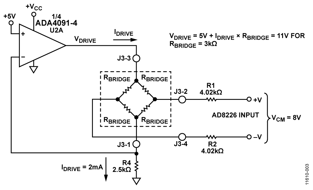

Excitation: Current Drive Configuration
By moving S1 farthest away from the identification mark, the circuit can be switched to the current-driven configuration shown in Figure 3.
In current drive mode, the circuit configuration is R4 = 2.5 kΩ and I DRIVE = 2 mA. Use the following equation to select the R4 value to obtain a lower or higher I DRIVE value.
CN0295_Image4
The driving voltage V DRIVE can be calculated by the following formula :
CN0295_Image5
The V CC supply requires 0.2 V headroom, so::
CN0295_Image6
CN0295_Image7
Figure 3. Sensor current drive configuration (schematic: all connections and decoupling not shown)

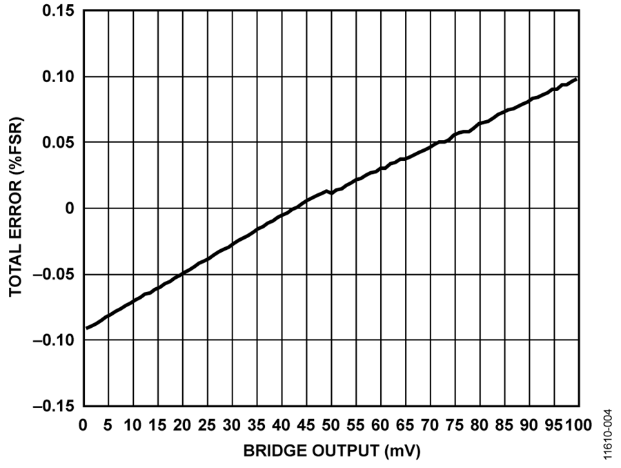

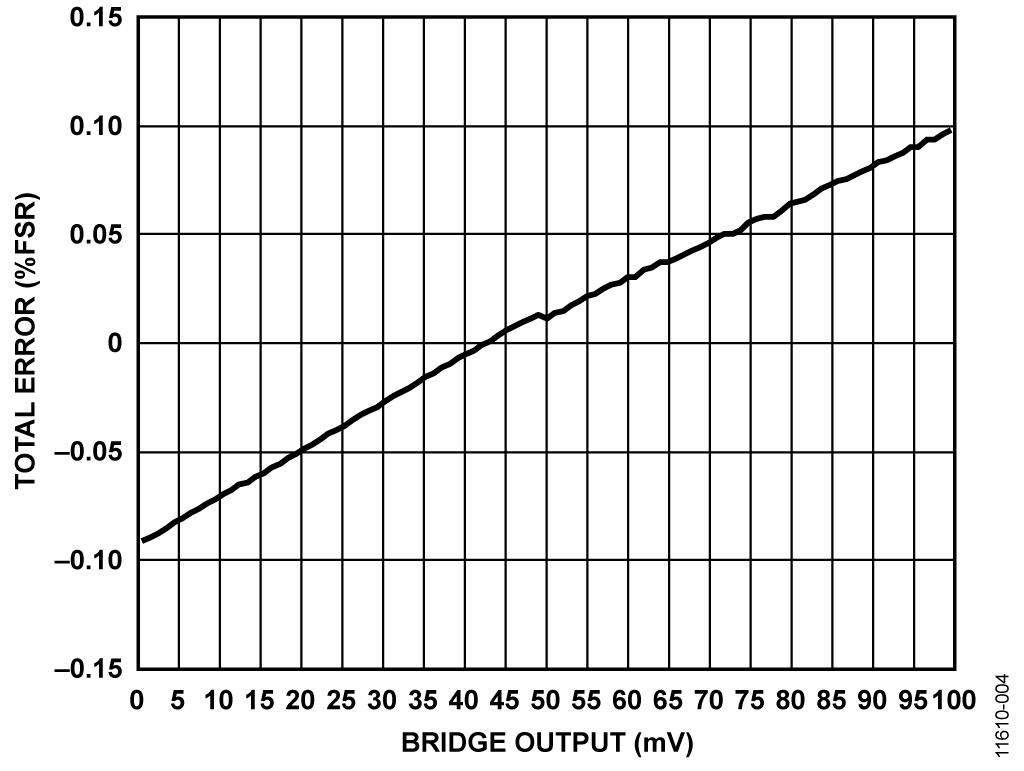

Actual error data for the circuit is shown in Figure 4, where V CC = 25 V. The total output current error (%FSR) is calculated by dividing the difference between the ideal and measured output current by the FSR (16 mA) and multiplying the result by 100.
Figure 4. Total Error in Output Current (%FSR) vs. Bridge Voltage (V CC = 25 V)
