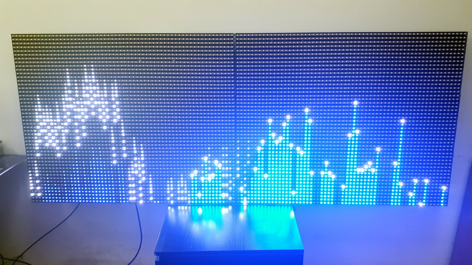

Pixblasters MS1 enables DIY enthusiasts and signage professionals, even those with minimal technical skills, to turn a bunch of addressable RGB LED strips into a giant video LED display. This FPGA-based LED controller enables new levels of professional-grade digital signage not possible with standard LED modules. LED strips can be bent and glued to different surfaces to create massive yet economically viable video installations that can span entire buildings.

Whatever is shown in the selected portion of the monitor image will also appear on the LEDs. No special anti-aliasing or font software is required. Use any digital signage software and add layered screen partitions, text, animations, videos, RSS... LEDs work at maximum speed and perfectly synchronized, regardless of the number of LEDs and linked MS1 controllers or display size.
    Display size and resolution:
A single MS1 can control 4.7/17.7 square meters (~50.6/190.5 square feet), while a daisy-chain MS1 ​​can control hundreds of square meters of LED display using 30 to 60 LED strips. A daisy-chain controller driving a total of 16,384 LEDs can support high-definition LED displays.

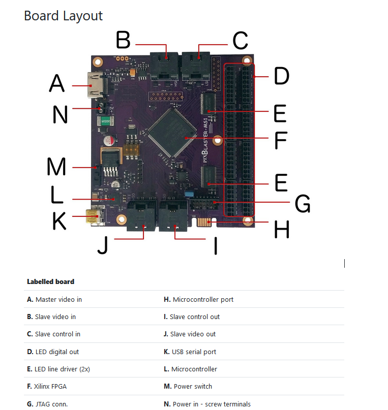

    The Xilinx® Spartan®-6 XC6LX9-3 FPGA chip
    has an onboard Microchip PIC18F26J50 microcontroller:
        The microcontroller connects to the PC, runs the configuration software, and permanently stores the configuration data. It also allows simple firmware updates with any new features.
    Output resolution (horizontal x vertical): 512 x 32 (native), 256 x 64, 128 x 128, 180 x 96, etc.
    Board size: 95 x 100 mm

参考设计图片
Blockdiagram
