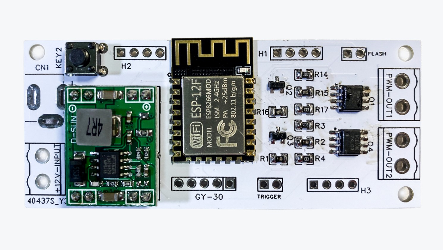

Introduction: A dual-channel n-mos dimmer based on ESP8266, with a GY-30 light intensity sensor interface and two human body sensor interfaces (supply voltage 12v), which can be used for two-channel sensor switches to control two-channel PWM light strips
1. Product Introduction
This project is developed using ESP8266 (ESP-12E module) for table lamp modification, smart night light DIY, etc. The light intensity detection uses the GY-30 light intensity sensor, which provides two human body sensor inputs and two MOSFET outputs. The human body sensor Pyroelectric sensors or microwave sensors can be used.

This product uses ESP8266 (ESP-12F module) as the main control
board with two-channel PWM dimming/speed regulation. The circuit can be connected to loads such as LEDs and DC motors.
It provides a GY-30 sensor module interface for light intensity measurement.
It provides two human body sensor input interfaces (two channels of 12V and 3.3V sensor power supply are reserved)
and one button interface

(1) Hardware selection
master: ESP8266 (ESP12-E module)
Light intensity sensor: GY-30 module
Human body sensor: RCWL-0516
N-MOS: NCE-3010S (Vds = 30V, Id=10A)
DC- DC module: 9-28V DC to 3.3V DC (non-isolated)
(2) Electrical parameters
Working voltage: 9-28V (12V recommended)
MOS tube supply voltage: Same as the input voltage (12V recommended)
MOS tube driving voltage: Same as the input voltage (12V is recommended. If the input voltage is high, the driving end voltage dividing resistor needs to be adjusted)
MOS tube working current: 10A
(3) Specifications and
parameters: 80mm x 34mm double-layer board

This project does not reserve onboard burning chips. You need to prepare your own USB to TTL module. The power supply of modules such as CH340
and MOS power supply are the same voltage. According to the DCDC module The input voltage range is determined. I am using a 9-28V to 3.3V non-isolated DCDC module. When purchasing, you need to pay attention to the size (the attachment provides a link to the module I purchased, you can refer to the module size).
Below the DC-DC module are the analog ground and digital If the magnetic ring connected to the ground is not needed, it can be directly short-circuited with a wire.
The production cost
is about 10 yuan
