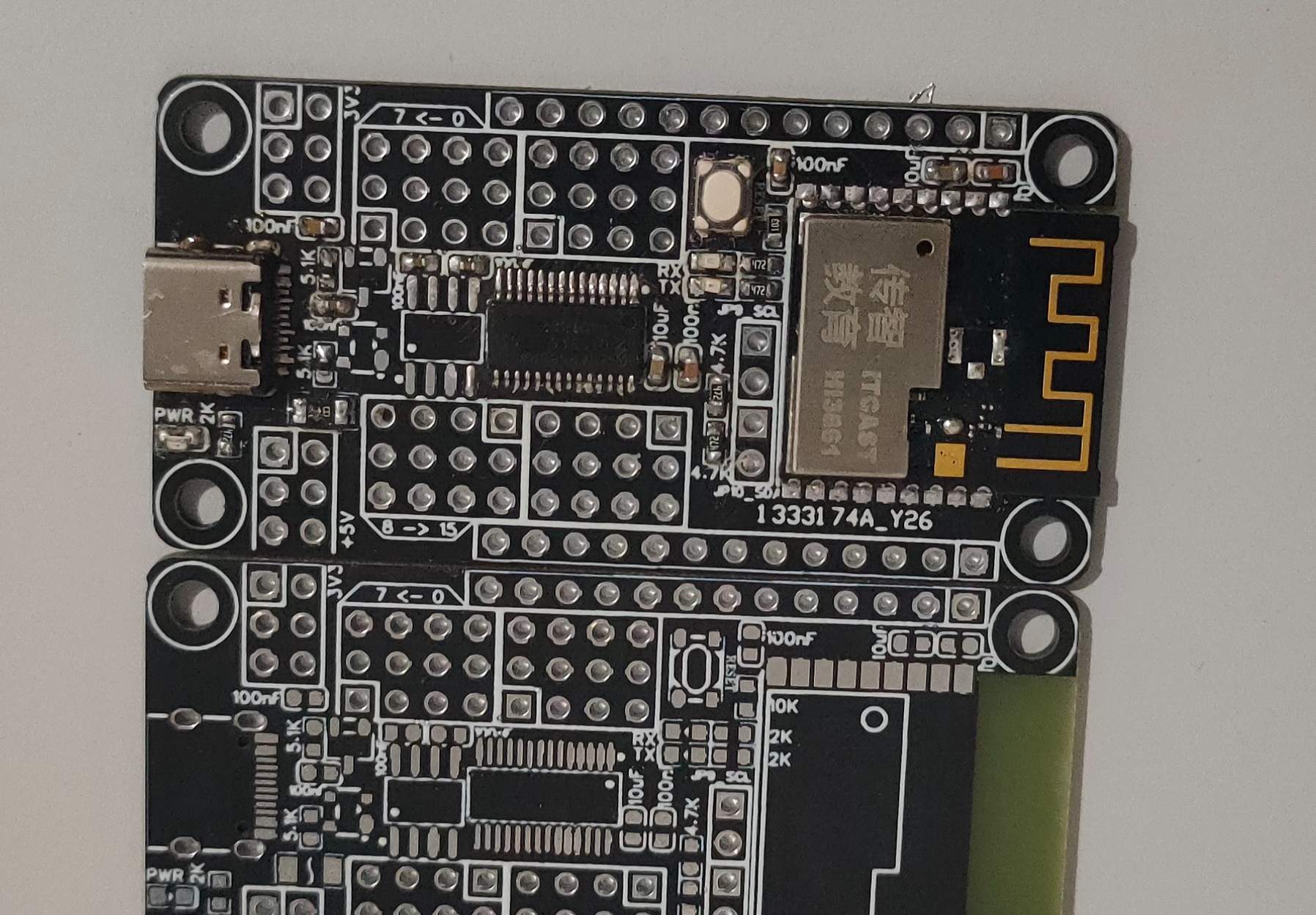

Development board design ideas:
  1. As small as possible, a small size development board of 3cm*6cm
  2. It is easy to program, using the Type-C interface, integrated ch340n serial port circuit, directly connected to the hi3861 main chip. Has sending and receiving indicator lights.
  3. Easy to expand, provides 5V power supply, 3.3V power supply expansion; provides i2c chip, expansion 16 channels.

software support:
The firmware can use the Hongmeng IoT system and provides rich API calls. Convenient Wifi network distribution and OTA updates.
You can use Linux for development and programming, which is much more convenient, but serial port programming is slower. It is recommended to burn the ota firmware, and then update the firmware via wifi, which is more convenient and faster.
Physical map:
It's a bit compact, the ch340n chip and 3.3v chip haven't arrived yet, so soldering is difficult!
