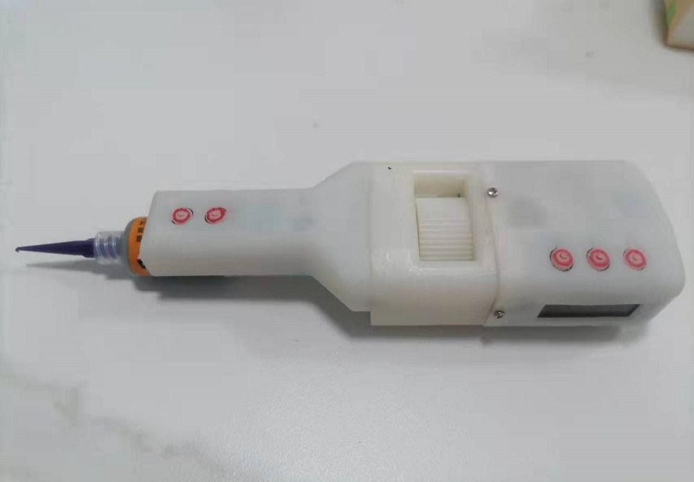

Open source paste dispenser ESPC3+BD6736+IP5306
If you do it next time, connect the PWM pin of BD6736 to 3.3V, saving an IO for the TL431 voltage reference, so that the calculated battery voltage is accurate
Materials include:
1-Precision N20 reduction motor: 6V, 60 rpm:
You may find this one: https://item.taobao.com/item.htm?spm=a1z09.2.0.0.76272e8dNGEA3p&id=647011240332&_u=b284nul06e4
2 -Motor driver IC: BD6736FV-E2. This is a camera lens motor driver. It can also rotate forward and reverse with PWM. It is very good.
You may want to look for this one: https://item.taobao.com/item.htm?spm=a1z09. 2.0.0.76272e8dNGEA3p&id=521782894451&_u=b284nula585
3-Battery is 400mA (19.7*38*7.3)
I purchased this: https://item.taobao.com/item.htm?spm=a1z09.2.0.0.76272e8dNGEA3p&id=6 49717471912&_u= b284nula65e
All accessories:
All accessories
The front handle is fixed with glue
1-Glue the handle button PCB to fix it
Front handle screws
2-Fixed handle
Finally, before installation, power off and test
2- First try to see if the OLED works properly
3-N multi-line+
If there is no problem after testing, install it
4-fit
Finally, the effect!
5-The final effect is that no stringing is required, and everything else is good.
I feel very good using this model for motor driver IC.
