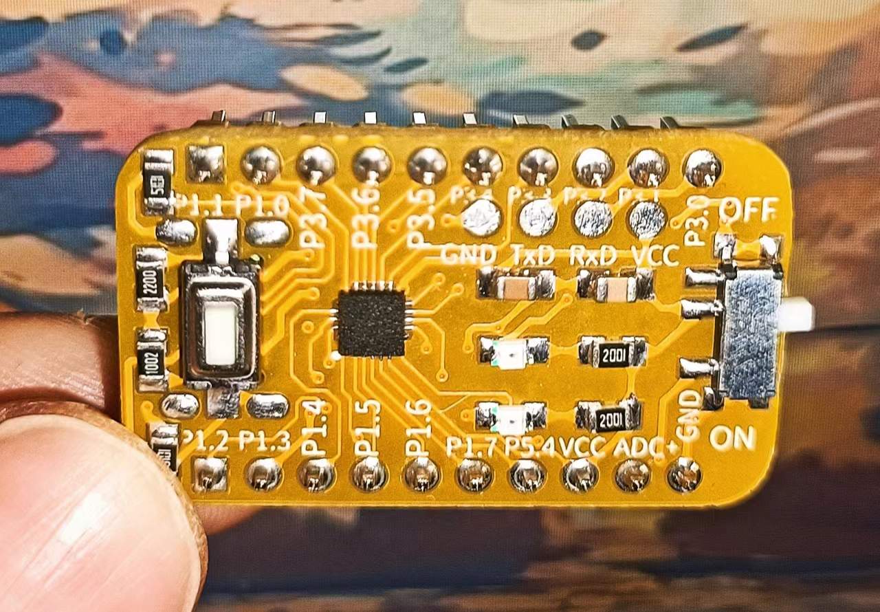

STC8H1K08 minimum system board
STC8H1K08 minimum system development board
System board front
Back of system board
The independent button on the front of the board is connected to P3.2.
The LED that is slightly closer to the capacitor is connected to P1.0.
The LED that is slightly farther from the capacitor is connected to P1.1.
The LED on the back of the board is the power indicator light. If this light is on, the MCU is powered on.
The development board has two burning methods:
USB direct connection burning.
                        1. Open the STC-ISP official burning software
                  2. Turn the switch to OFF (turn off)
                  3. Connect the development board to the computer through a USB data cable
                  4. Keep pressing the onboard independent button, and then turn the switch to ON (turn on)
                  5. At this time, the computer automatically recognizes the microcontroller and displays it as STC USB Writer (USB1)
                  6. Select the .hex file to be uploaded and burned, and click the Download/Programming button
                  7. The code is automatically uploaded for burning
(Note: When using the USB burning program for the first time, you need to install the STC chip driver. To install the chip driver, you need to install the updated driver in the device manager after completing steps 1, 2, 3, 4, and 5. When installing the driver, you need to change the computer's Driver force signature is turned off, otherwise the driver cannot be installed.)
TTL serial port burning.
           Just connect the USB-TTL module cable to the burning probe, and push the probe to the 4 burning points to complete the burning.
What? You don't have a burn probe?
                 I have a burning probe in my mini handheld oscilloscope project.
This development board supports USB to Type-C data line burning, and also supports Type-C to Type-C data line burning.
                 Supports direct insertion into hole boards.
Notice! When making the board, just make the board directly and ignore the warning. It has been verified that the system board can be used normally.
This time we provide two different chip packaging development board solutions.
                    QFN-20 and TSSOP-20
