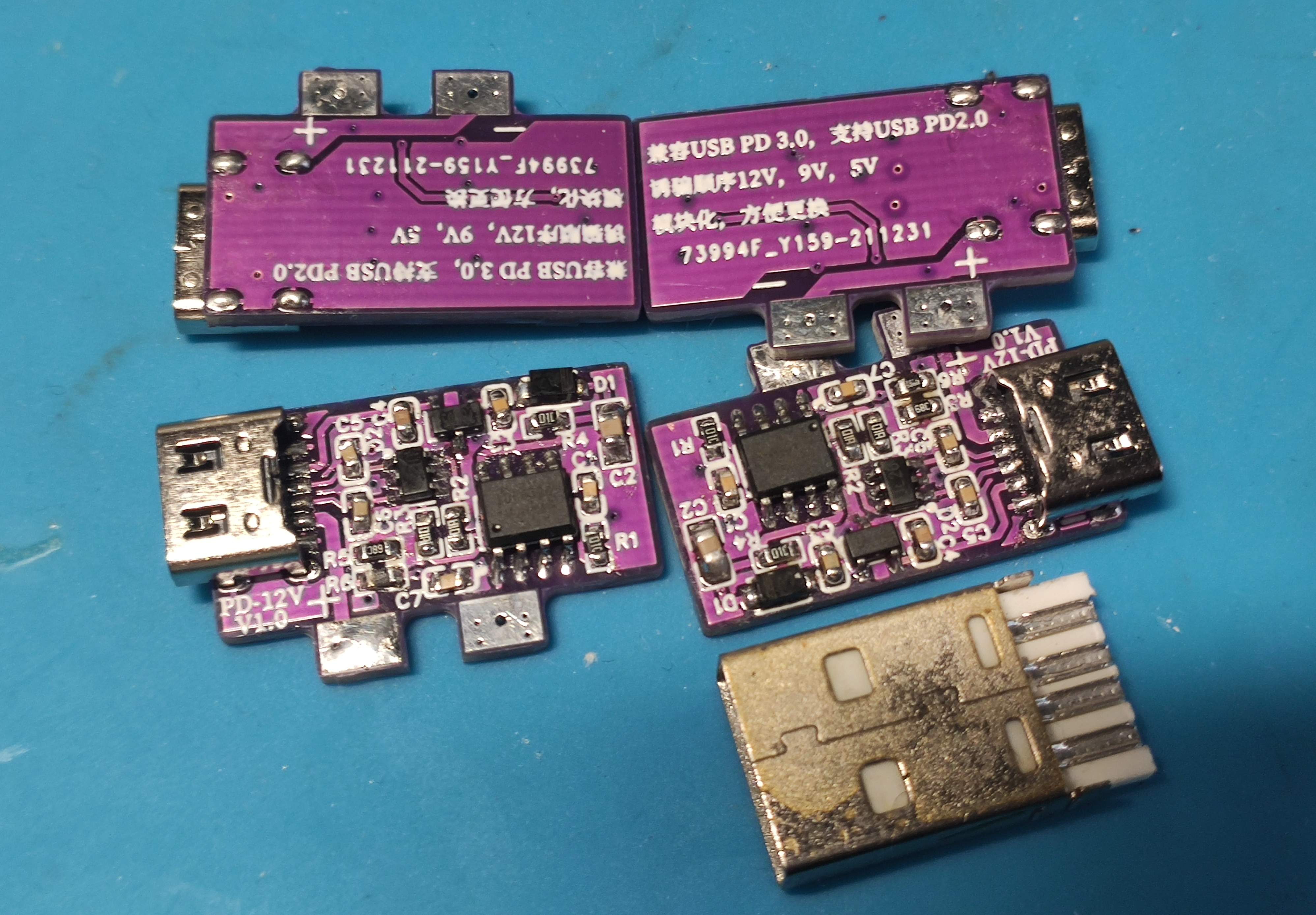

PD deception module-LDR6328-physical product has been verified
This module is not allowed for commercial use
The module can be placed on the PCB by directly using the " power interface socket " of YIRUHUA. ( The package is currently not verified, but it is theoretically possible )
Because only the PD protocol is used , a 6-pin Type-c interface is used . If you need QC, please add relevant circuits and interfaces yourself.
2022/1/5
Welding is done at night. When the LDR6328 chip is not welded, ( using a multi-protocol power bank for power supply ), the output can be measured to be 5.1V, the voltage between pin 8 of the chip and ground is 3.7V ( 5V passes 7805 ), pin 6 is 5V to ground, and pin 5 is 1.4V.
Finally test after soldering the chip. Family portrait.
