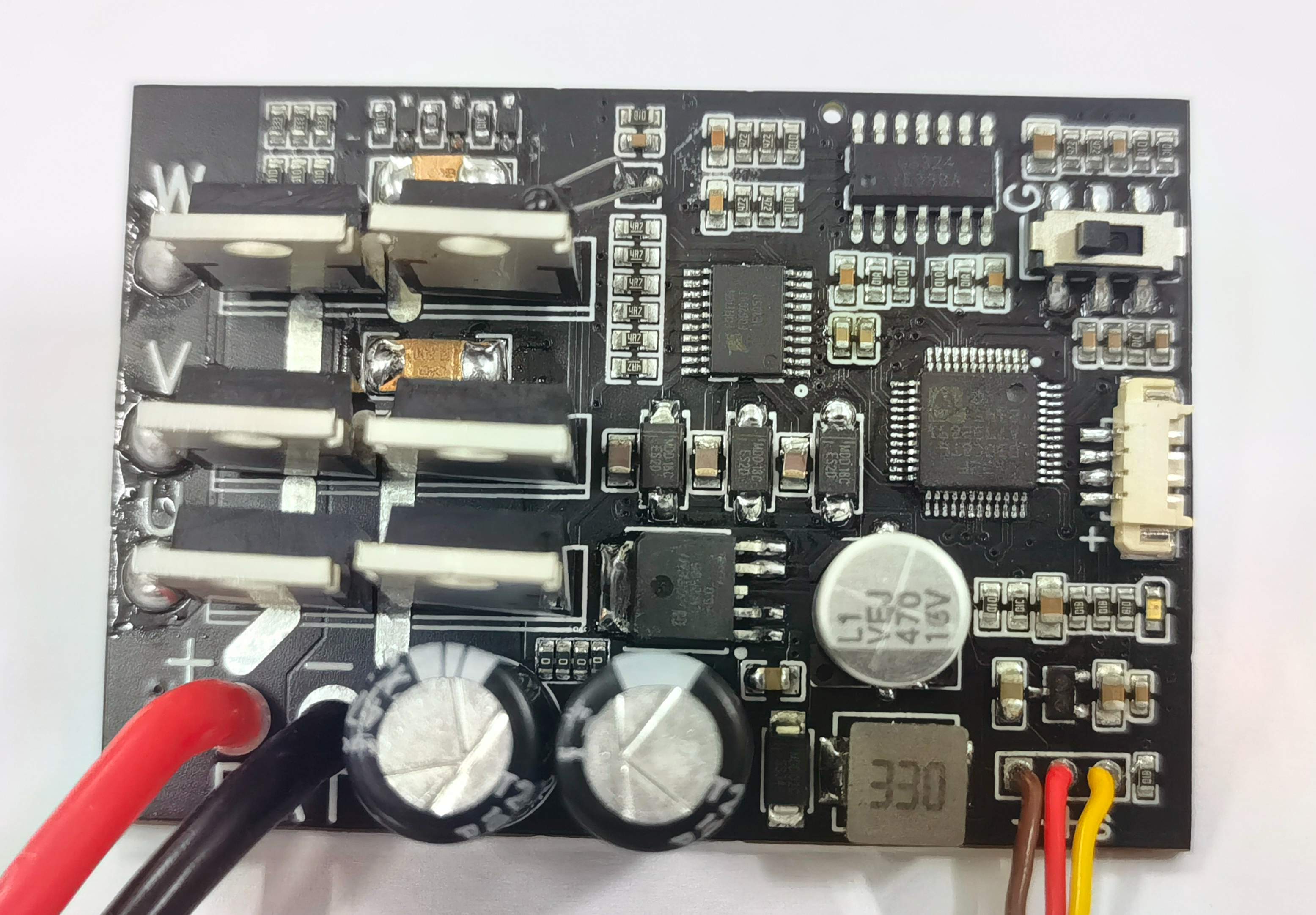

The current version starts smoothly and runs stably. Source code file ''source_cwesc_22-06-10-1.rar''.
Supplement and summary of the features of this open source project are as follows:
1. Two-way brushless ESC.
2. PWM signal input, high pulse width range 1000~2000us, greater than 1500 for forward rotation, less than reverse rotation.
3. Complementary PWM output, synchronous freewheeling, and the lower arm generates almost no heat.
4. 75% of the time is when the PWM high level is used to collect back electromotive force, and the data is more accurate at lower levels.
5. With serial port output, two-way data transmission, interrupt sending and receiving. Easy to debug and takes up very little CPU time.
6. Start-up is divided into two stages, and it can start normally even with large load, large torque or reverse rotation.
7. With over-temperature and over-current protection.
8. With phase loss protection.
Upload several back electromotive force waveform diagrams. The picture is drawn using the serial port software vofa+, and the ESC sends the data to the host computer.
* pwm_in is the pwm input duty cycle, 430 means 43%.
* Red is the virtual median, and the other three lines are UVW three opposite electromotive forces.

// first version
cwesc, brushless and inductive ESC.
1. The main control is cw32f030
2. Power supply in 2~4s
3. Enter pwm
4. With serial port debugging
5. Over-temperature and phase loss protection
6. Synchronous continuous flow
Continuing debugging...
** Video 1 is the first version.
** Video 2 is firmware 220608, with counterweight motor for forward and reverse rotation, high current and high torque.
