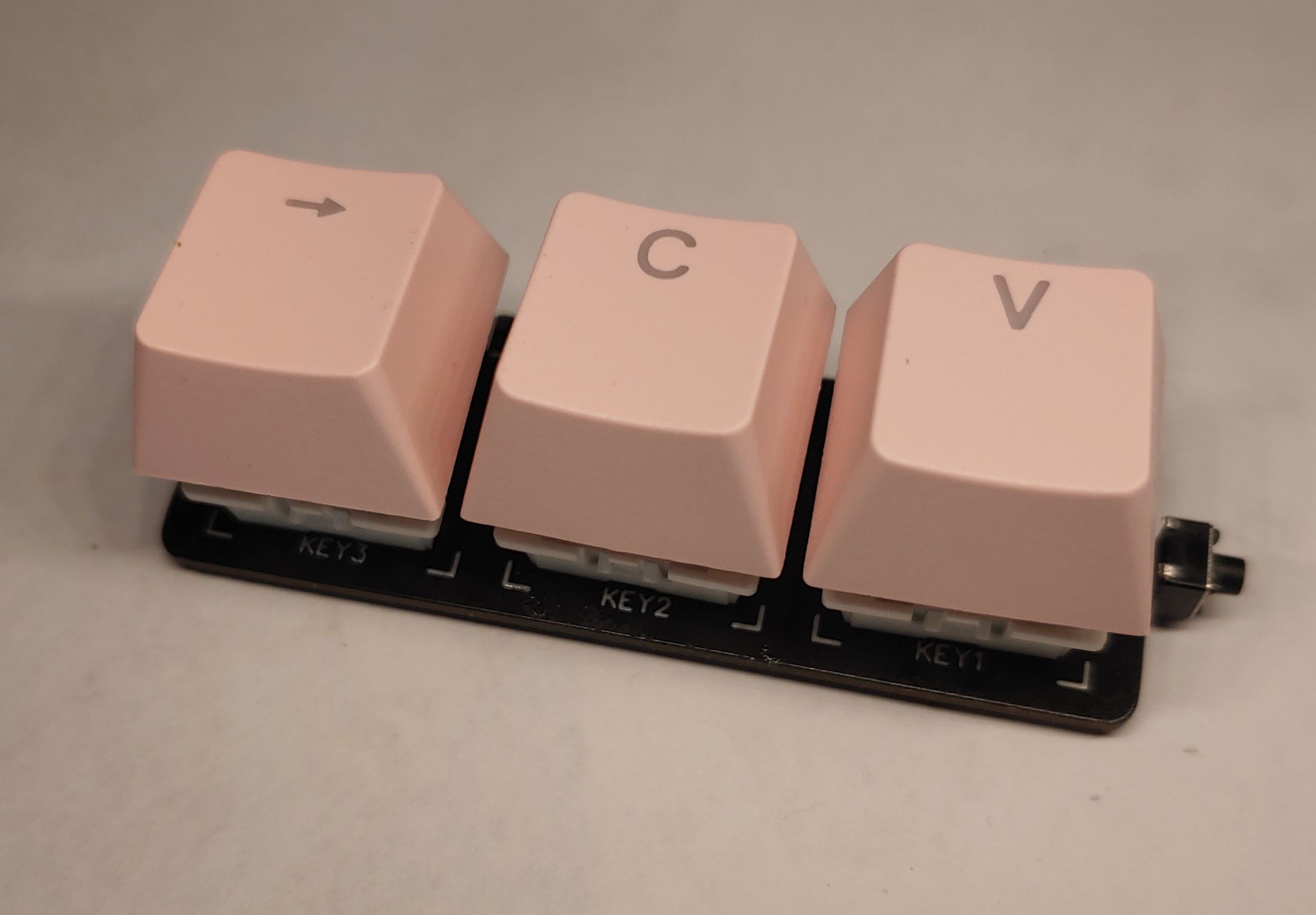

Reproduction of CV engineer keyboard (analog keyboard based on CH552)
I saw the cv engineer keyboard when I was watching videos on Bilibili. I went to a certain store and saw that it costs 3-40 yuan each, so I thought I might as well make one myself. The key switches cost 8 yuan for 10 pieces, the single-chip microcomputer costs more than 2 yuan, and the resistor, capacitor and type-c interface transistor only cost about 1 yuan in total. The board is from Jialichuang, and the cost per unit is not counting the keycaps and casing. About 6 yuan. The program part was developed using Arduino and was completed in less than half an hour. It can also be modified into one-click macros in the future.
