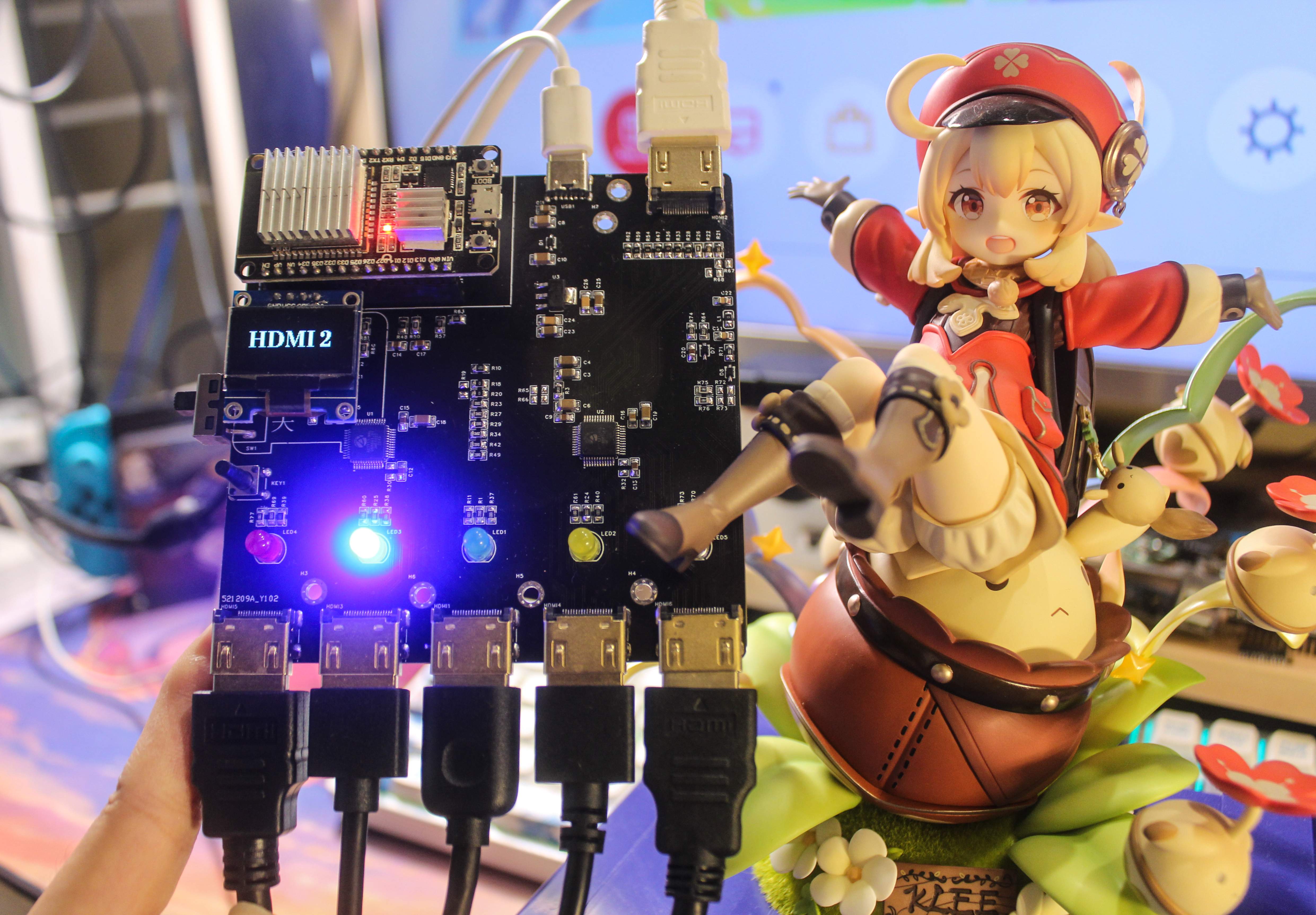

Use two AG7111 + ESP32 to make an HDMI 5-in and 1-out I switch, suitable for a variety of purposes

Now two AG7111 are used here, so there are RXSEL1 and RXSEL2, both of which are connected to 2K pull-down.
This RXSEL is voltage controlled. According to the input voltage value, the output AG7111 can choose which HDMI port to output. Then we can use MCU to control their voltage.
This RXSEL is directly connected to the D25 and D26 ports of the ESP32
Here is a diagram of the IO ports. You can see that D25 and D26 are exactly two DAC ports, so they can be used here.
Because there is no specific voltage specified in the specification sheet here (in fact, the specification sheet for the purpose of this port is not even written, I just figured it out by myself)
Here I tried out the corresponding relationship between ports and voltages through repeated trials:
port Voltage (V)
HDMI1 0~0.2V
HDMI2 0.8~1.2V
HDMI3 1.8~2.2V
The above table shows the corresponding relationship between HDMI switching port and voltage.
If the voltage is not within this range, an abnormality will occur.
According to the above table, and with the drop-down 2K, we can implement control in the code
For example, port 5, which is the rightmost port of the PCB, is actually the first port of the second chip, and the first chip will not be used, so the first chip can be chosen casually, that is, as long as the second chip RXSEL2 (D26) Just choose HDMI1, so the voltage of 26 is 0
For example, port 2, which is the second port from left to right on the PCB, is actually the second port of the first chip, and then output to the third port of the second chip, so RXSEL1 (D25) selects the middle of 2 Voltage, this value is 62. The second chip RXSEL2 (D26) selects the third port and is connected to the output of the first chip, so select 3. The one with the largest voltage value is 160.
In fact, if you look at the order of chip layout and wiring, the rightmost one should be the first HDMI port, but it does not conform to our common habits, so I reversed their order.

You can choose one of the LED indicators and the screen. The screen does not display any other status. In addition to displaying the HDMI port, it also provides an indication that there is no HDMI output. The indicator light can be displayed, and the screen can also be displayed. We will continue to improve on this basis when we make KMV in the future.
4. Precautions for use
It must be connected to an external TYPE-C 5V power supply, otherwise it cannot be used.
The left switch only controls the HDMI switch, the ESP32 and screen are not controlled.
