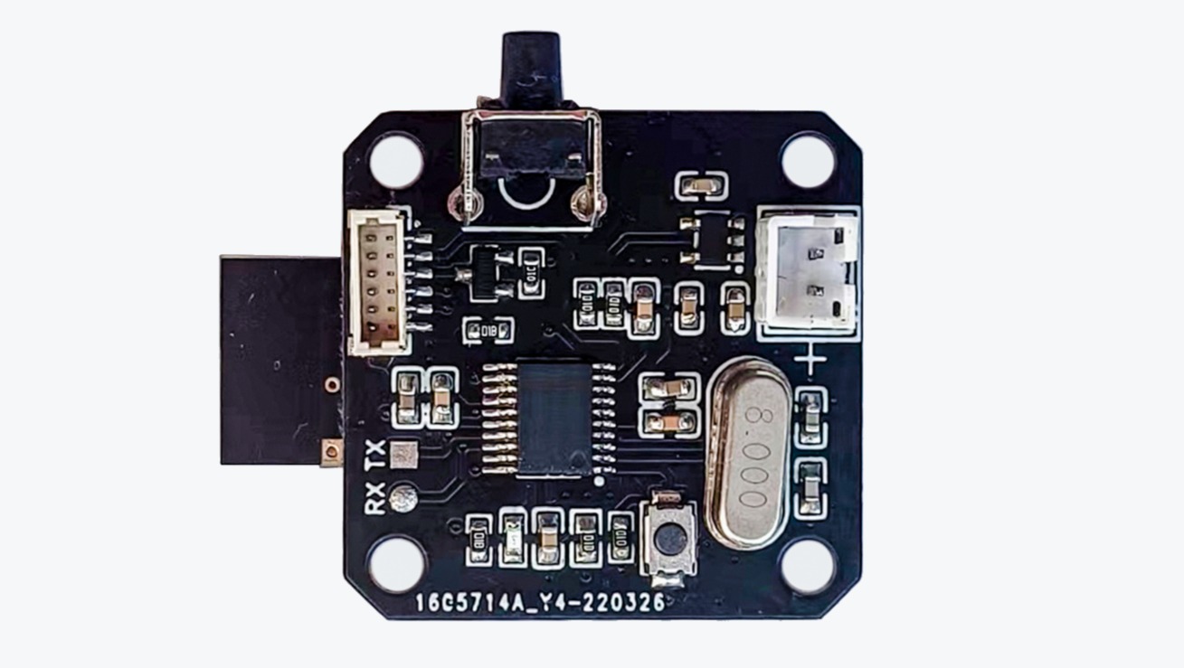

3. Product Overview
1. Application requires another host to be used, and the host depends on your application scenario. This device only acts as a slave machine and only completes fingerprint entry recognition and wireless communication with the host machine.
2. This device can be paired and communicated with different hosts, as long as the wireless communication chip solution of the host is SI21R1. This project provides the SI24R1 driver library, which can be used to simply and easily configure the Si24R1 and communicate with this device. Pairing
3. Fingerprint module driver library. This project has encapsulated most functions into functions according to the data protocol of the fingerprint module. You only need to call a function to send corresponding commands to the device and enable the device to implement corresponding functions, such as fingerprint registration, fingerprint matching, and deletion. Fingerprints, etc.
4. The main control is STM32F030F4P6
5. The 2.4G chip solution is Si24R1, and the Si24R1 driver library is provided. The Si24R1 chip can be configured and used simply and easily.
6. One-click pairing. Using the provided driver library, one-click pairing can be achieved, even if two strangers Si24R1 establishes connection and communicates
7. Area array fingerprint sensor, the sensor surface is covered with a protective coating, and has RGB three-color LED lights to support the storage of 60 fingerprint features (spliced ​​6 times)
4. Product parameters
PCB size: 29*29.6mm, Double-sided layout, with devices on both sides
Input voltage: 3.6V-6V
Mounting hole size: M3*4, spacing 23*23mm
Static power consumption: 55mA
Working state power consumption: 60mA (No LED lights up, if the LED needs to light up, Then each additional color of LED lights up, and the power consumption increases by 10mA)
Fingerprint module parameters:
FAR (FalseAcceptanceRate): <1/1000000
FRR (FalseRejectionRate): <1.5%
Response speed: feature extraction time <0.20s, single matching time <0.002s
supports fingerprint splicing, the maximum number of splicing times: 6 times
Number of fingerprints: 60 fingerprints (splicing 6 times)

6. Remarks
1. Firmware needs to be burned. Use the serial port to download. You need to prepare a USB to TTL serial port tool, such as the common CH340 module. The firmware and software required for burning have been uploaded. In the attachment, the burning method is in the attached "Instructions for Use" document
2. The average unit price of small batches (10 PCS) is about 40 yuan (the total price of all components of a single product, including fingerprint modules and 2.4G communication modules, PCB cost is not included)
3. The purchase links for all the devices that need to be used have been placed in the attachment
. 4. The attachment contains all the required information and detailed instructions for use
. 5. The PCB proofing of this module does not have a silk screen position mark, which is in the "Instructions for Use" "There is a "silk screen component location map" in it to make it easier for everyone to solder by themselves.
6. The application requires another host. The host depends on your application scenario. This device only acts as a slave machine and only completes fingerprint entry recognition and wireless communication with the host machine.
7. This device can be paired with different hosts, as long as the 2.4G chip solution of the host is also Si24R1, and the provided Si24R1 driver library can be used to enter the pairing state. The driver library has been uploaded in the attachment.
