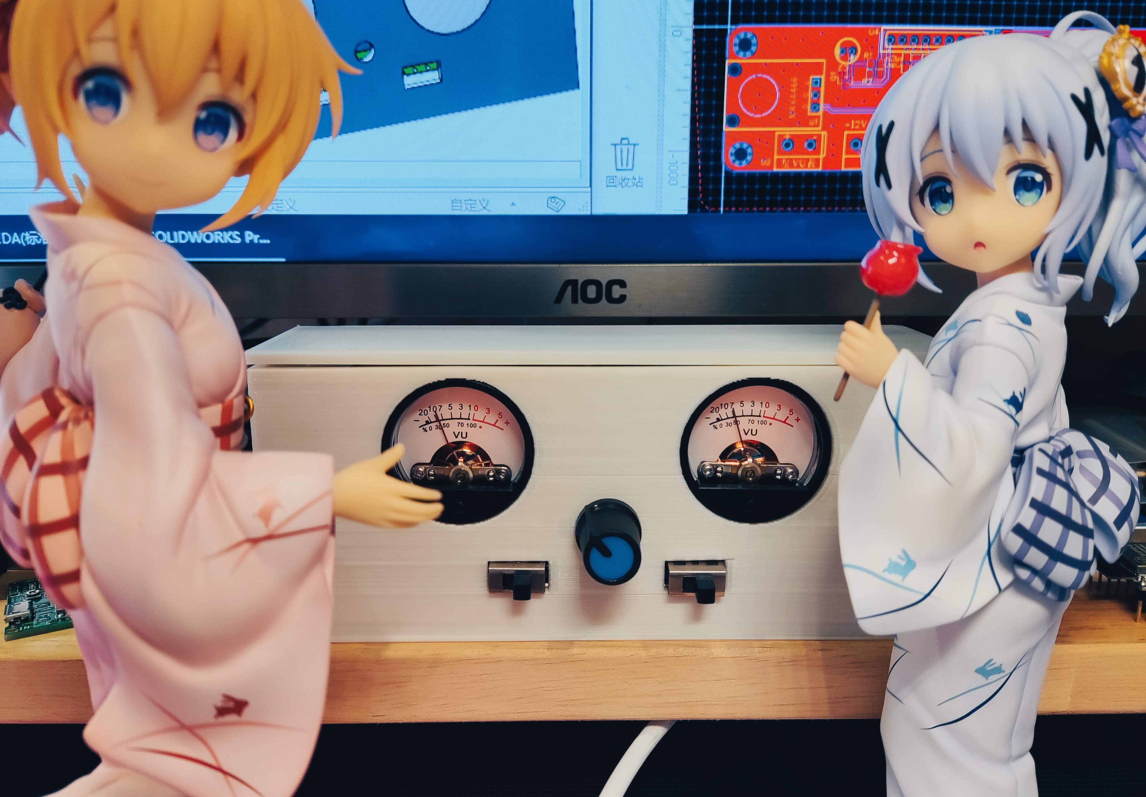

7. Housing/Assembly
Draw using SOLIDWORKS, see assembly 3.SLDASM for the source file
Required parts:
The shell is divided into two parts
There are files that can be printed directly without SOLIDWORKS
See 1.STL 2.STL
It is recommended that the wiring should not be too thick, so as not to affect the assembly, and the internal space is limited.
The shell of this castrated youth version of the pickup meter can only be 3D printed, not acrylic. Because the PCB is too small to fit the VU meter, and the charging port is too far away from the case if it is enlarged.
The upgraded pickup meter (clone) will draw 3D printed and acrylic shells, use a more advanced and larger VU meter, and may try to use the professional version of Lichuang EDA 3D shell drawing and panel drawing functions (JLC can you let me pick up the wool# sinister smile). Stay tuned!
8.VU meter
This case is for this company ’s VU meter: first, it is smaller in thickness and volume, second, it is cheaper, and third, the backlight does not distinguish between positive and negative .
If you want to use other meters by yourself, please confirm the parameters: 0-500uA, internal resistance 650 ohms!
Otherwise, you need to manually determine the resistance parameters to adjust the left and right balance in Section 6.
