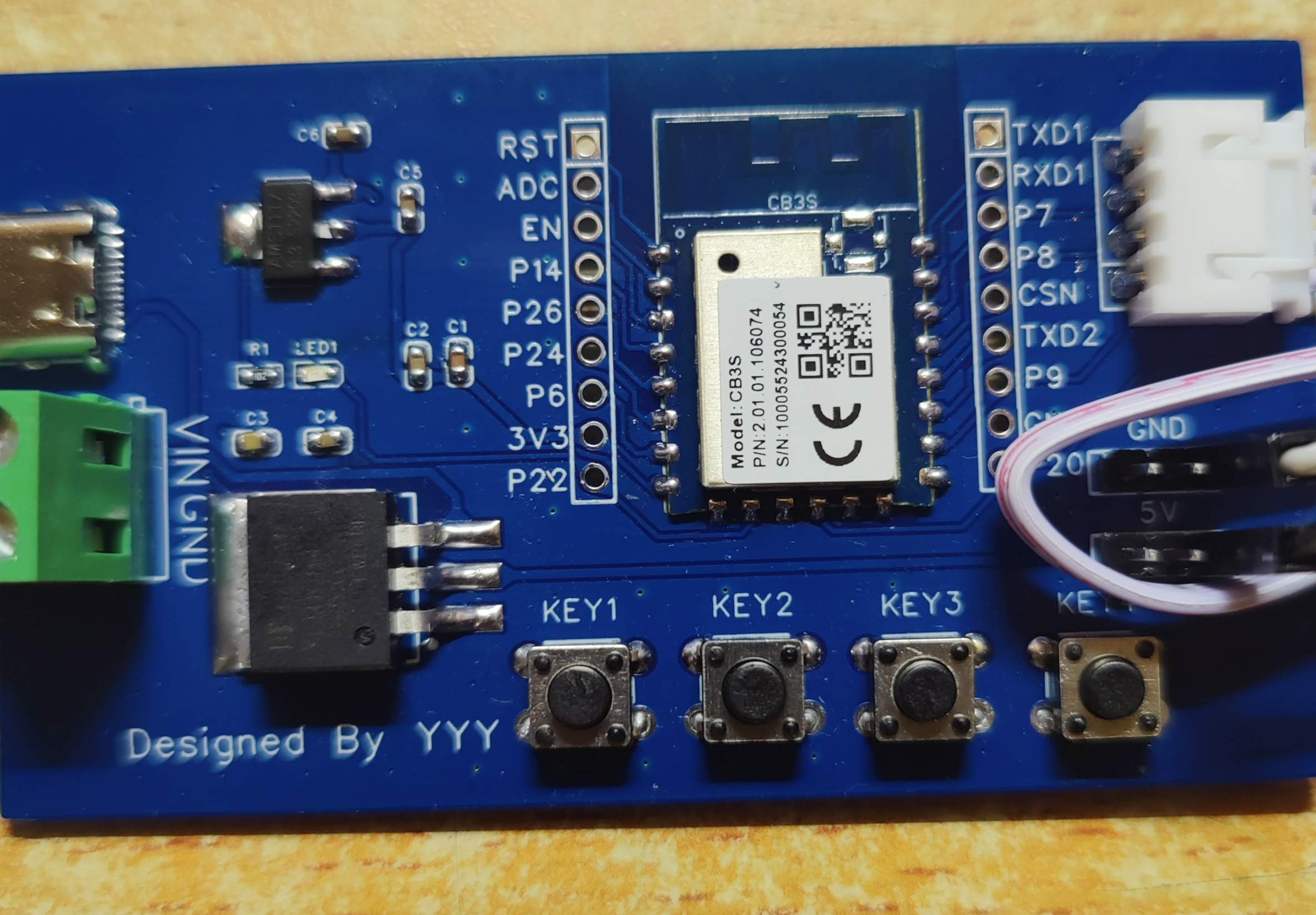

After the platform development is completed, the platform will provide a recommended circuit schematic diagram based on the selected equipment and functions. Based on the schematic diagram, the PCB design is completed using EasyEDA (Professional Edition), and one-click PCB proofing and component purchase are achieved through the client, which is very convenient and fast.
The product can be powered by the Type-C interface or by a terminal block. The DC voltage should be less than 12V and greater than 6V. The product contains two DC linear step-down circuits, one for stepping down 3.3V to power the main control chip, and the other for 5V to power the relay module.
3OZeQNQMC9vN9ccHkW3ycGmopZ90Wp5ks6KI82bW.pngcZeg8a05XOSC6tS68PYMbGnqUW7Tkb4kbIFJFhUY.pngWelded PCB board
qOkiNOFua1QirpSsXqfxsKKyHLKtxakOScuyzvU4.jpegU1lRDb9uz2gw5CZIEKFVRye5BXCyK0N0gkAB8Pkq.jpeg
