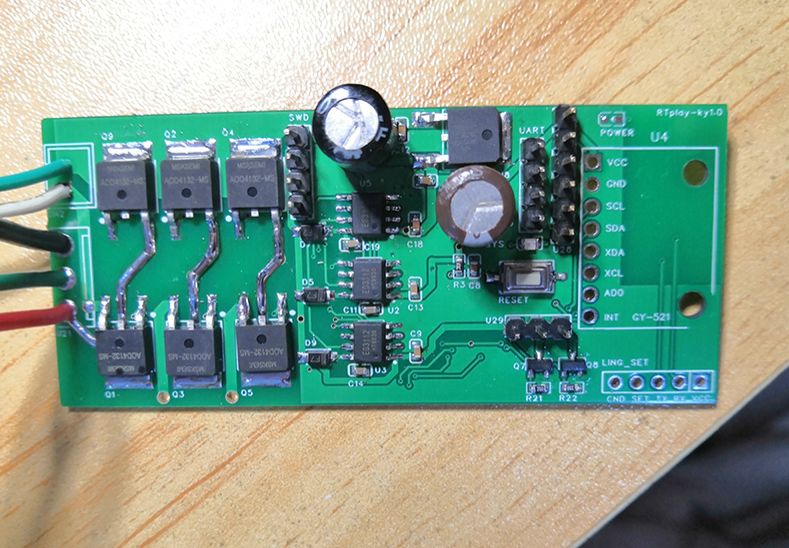

The project is divided into two parts: the main control part and the terminal part. The main control part is designed as an 8-channel analog handle and supports some special functions, using CW32 as the processor; the terminal part is designed to drive 1 brushless motor and 3-4 rudders. Machine, 6050 does attitude detection (whether it is implemented according to the actual situation). The main control and terminal communicate through 433M wireless communication, and the communication distance is more than 500 meters. The transmission execution delay is within 100ms. This system implements the most simplified aircraft model control system and can return some key parameters from the terminal, such as power, speed, etc. This system can eventually be used in model aircraft control, simplifying the difficulty of model aircraft production and making it easy to transplant the system, making it simple and easy for aircraft model makers to devote most of their time to the production of aircraft models.
Motor driver board

Physical map
