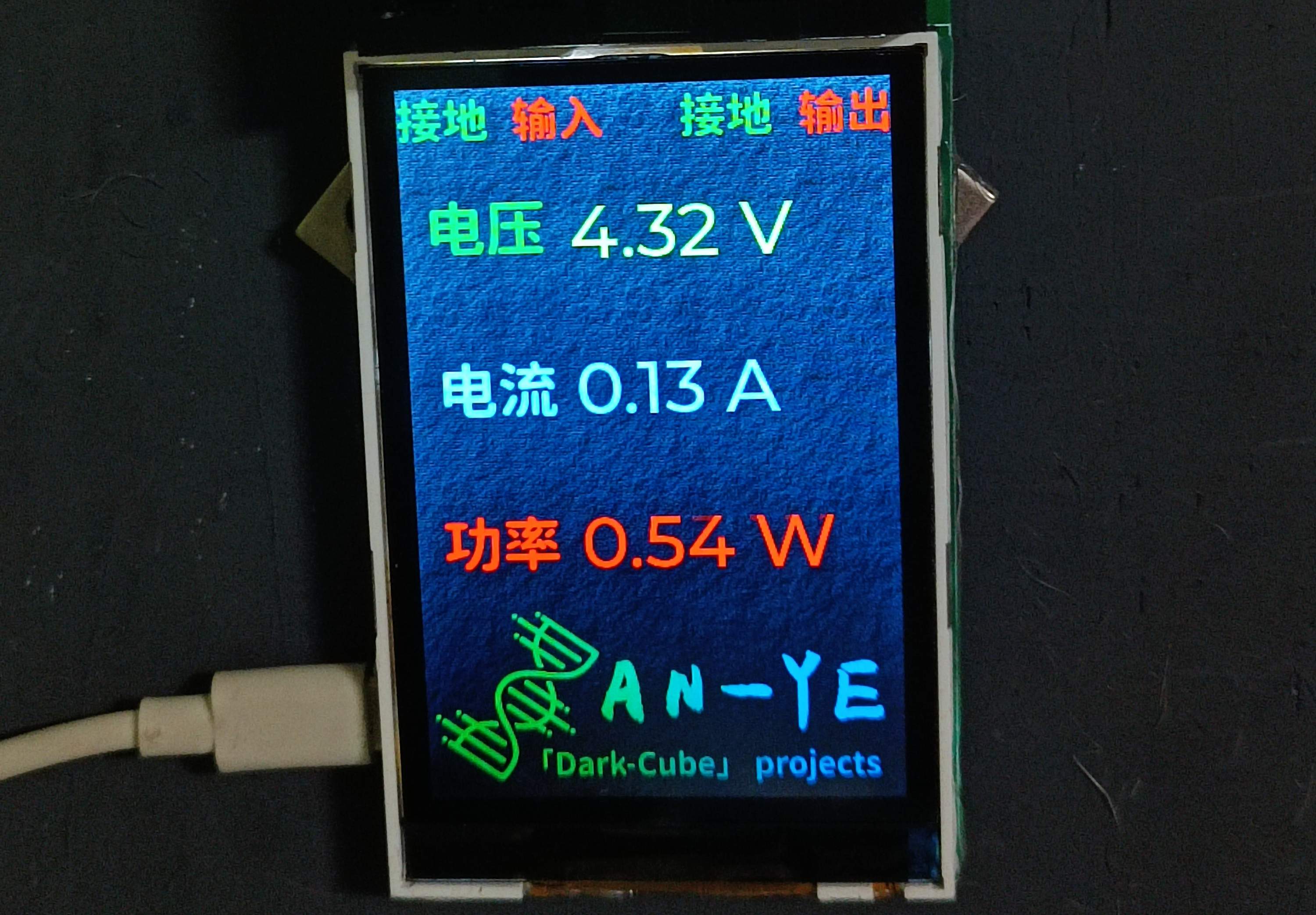

SH-201_Smart solar power meter
3.2-inch large screen voltage and ammeter

0x02: Hardware part
  • Main control MCU: ESP32S2
  • INA199 current sensor
  • AHT21 temperature and humidity sensor
  • TFT8K2798 screen, the display effect is OK
  • Magnetic suction on the back, easy to fix on the wall (requires wall support) ps: Tutorial on magnetic suction on the wall is on the back
0x03: Software part
  • System: Arch Linux
  • Development environment: Esp-idf 4.3
  • Display frame: LVGL7.2 (modified underlying functions, not universal)
  • Based on Espressif's official porting project lv_port_esp32
