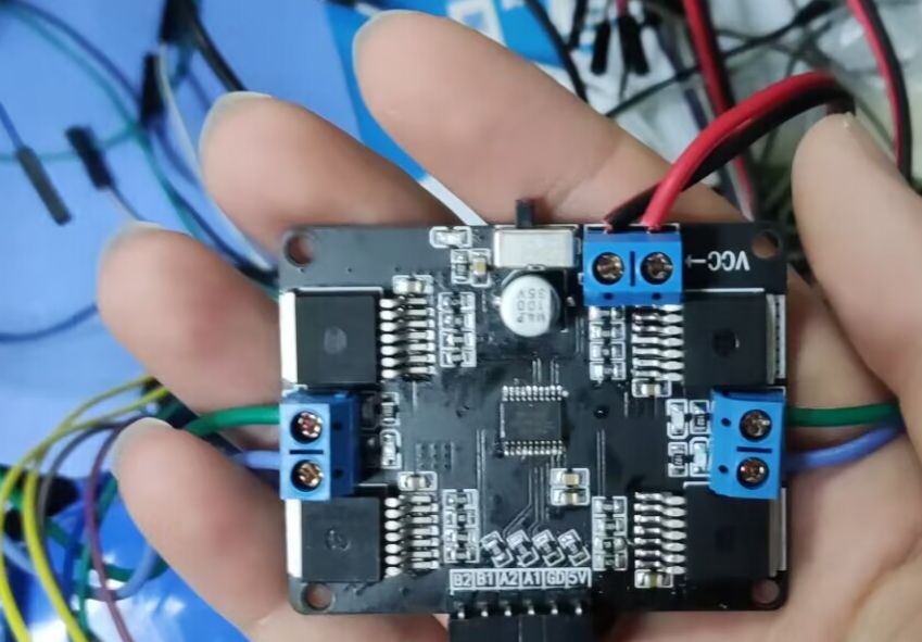

newrudeman
BTN7971B dual-channel motor driver module

#### ESP32 test program```c
#include
const int AIN1 = 16;
const int AIN2 = 17;
const int BIN1 = 18;
const int BIN2 = 19;
void motorA()
analogWrite(AIN1, 255);
analogWrite(AIN2, 0);
void motorB()
analogWrite(BIN1, 0);
analogW rite(BIN2, 255);
void setup()
void loop()
motorA();
motorB();
参考设计图片
