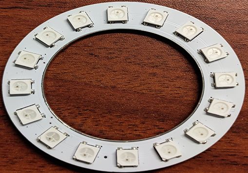

2. Project description
The running water lamp uses a full-color LED with built-in WS2812, which is driven by a single line. The driving timing requirements are relatively strict. This project uses the PWM inside the microcontroller for driving, and the timing is used according to the values ​​required in the RGB lamp manual. The logic analyzer has been carefully debugged to ensure that there will be no data transmission errors;
in terms of hardware, do not solder the parts marked DNI in the schematic diagram. The reserved position is convenient for using other methods such as SPI and serial port mode 0 to drive RGB lights;
burning When recording the program, please note: Select the 24MHz frequency in the STC programming tool, and use the reserved test points for programming.
