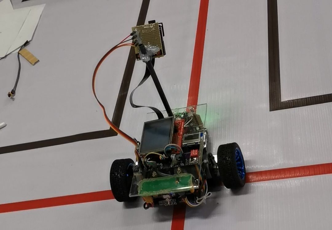

(1)    To achieve the above requirements, the most basic thing is to first let the car patrol the line. This work uses TI 's development board MSP430F5529 as the main control chip, the DRV8701E full-bridge drive circuit to drive the motor, and the K210 camera for tracking.
(2)    Followed by digital recognition. OpenMV , k210 , Raspberry Pi and other visual microcontrollers can be used for identification. Since the template matching efficiency of openmv is not high and the accuracy is low, Raspberry Pi has never been used. Therefore, this work uses K210 to take photos and samples of the simulated scene to create a ward number recognition training set. The training set is processed and a laptop GPU is used to train yolo2. The target detection model finally achieves high-precision recognition processing of ward numbers.

For this work, we used MSP430F5529LP as the main control chip to meet the debugging and control needs. Through the simplification and optimization of the module, the entire mechanical structure of the car is ingenious and reliable. Two reduction motors and a universal wheel were used for motion control. The K210 development board was used to take photos and samples of the simulation site to create a ward number recognition training set. The training set was processed and a laptop GPU was used to train the yolo2 target detection model. Finally, high-precision identification processing of ward numbers is achieved.
6. Physical display
