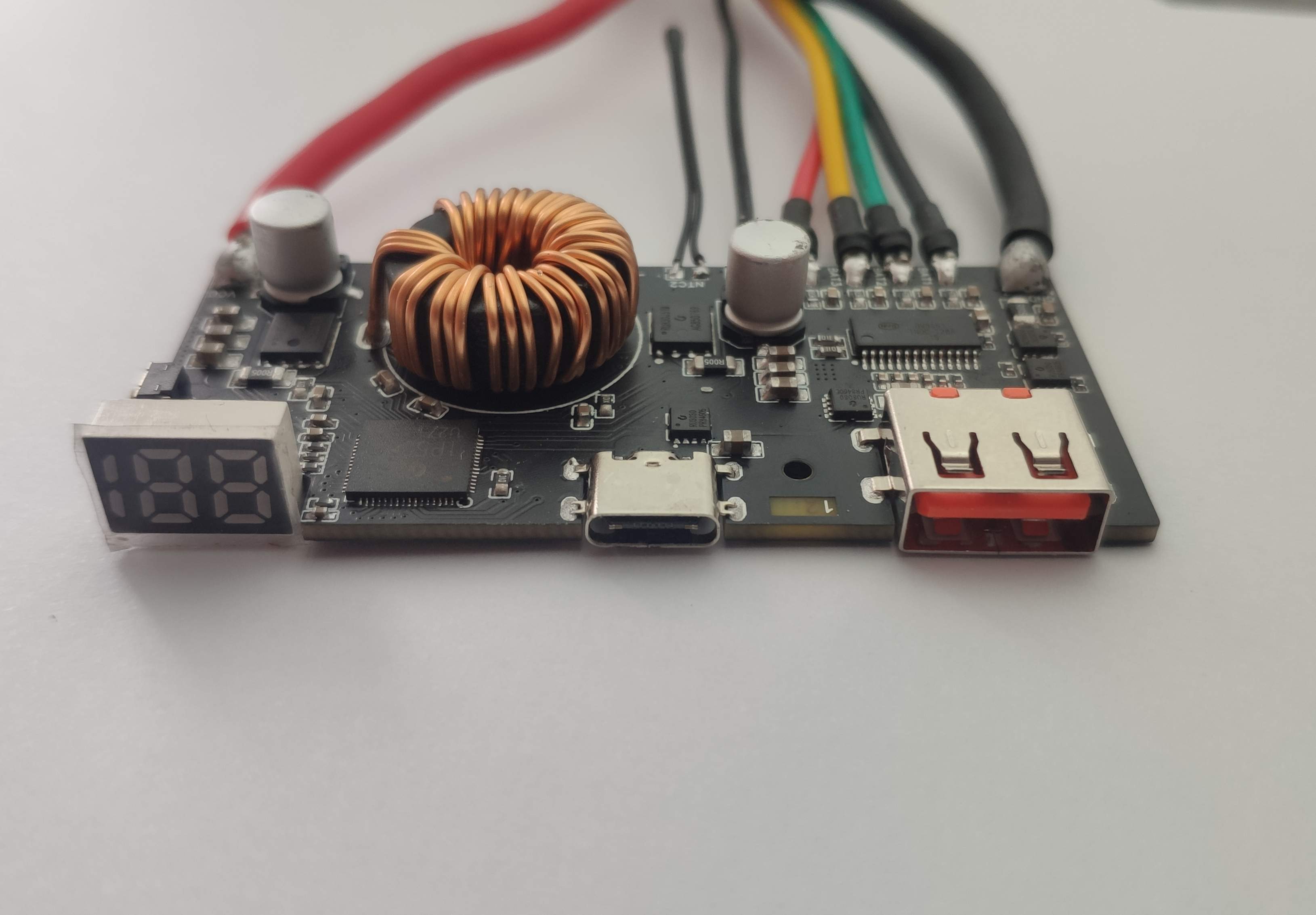

Modified based on the V1.0 version Demo (click on the text to jump)
Supports 4 strings of ternary lithium batteries (TYP 3.7V)
Maximum input and output power 100W
Integrated 4-string protection board
Some chips of the mobile power supply are IP5389_BZ
Some chips on the protection board are BM3451TNDC_T28A

PCB size is 70*33mm, and there is currently no casing (preparing to use 3D printing to make the casing, modeling in progress)
The word "neng" is dusty, it's not a process problem
For TYPE-A interface protocol testing, the VOOC DASH protocol is supported, but the low-voltage and high-current protocol USB meter cannot test it. The QC protocol supports QC3.0 and supports up to 12V output. The USB meter can’t detect it either, but it can be detected by using it.
TYPE-C interface protocol test, supports maximum PD 20V 5A 100W output, PPS supports 3.3-21V 3A output
In the charging test, since the test battery pack uses 4 series of 1 parallel 2500mAh power 18650 batteries, the maximum input is only 85W. At this time, the battery terminal current is 5A, and 2C is basically the limit of this battery.
