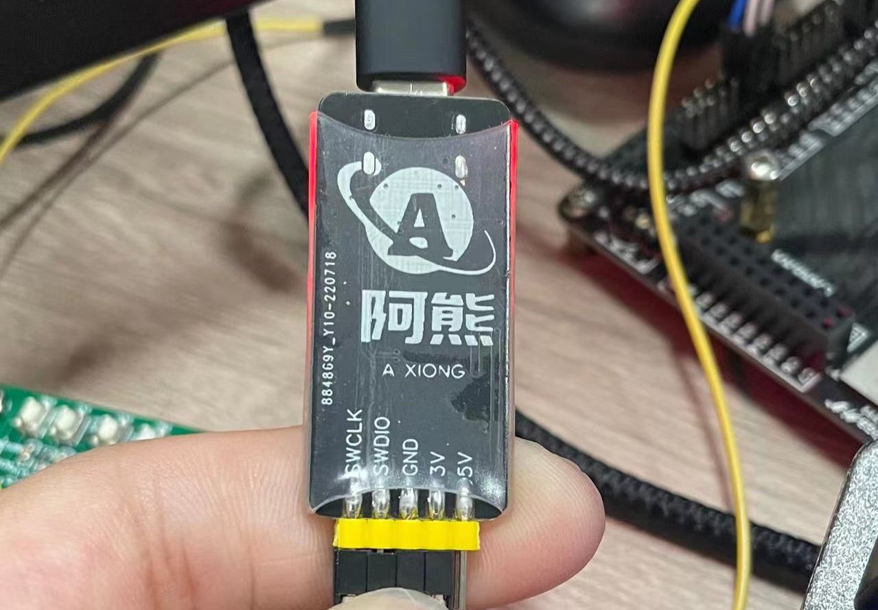

The WCH-Link module can be used for online debugging and downloading of Qinheng RISC-V architecture MCUs, and can also be used for online debugging and downloading of ARM core MCUs with SWD interface. It also has 1 serial port for convenient debugging output.
picture:
