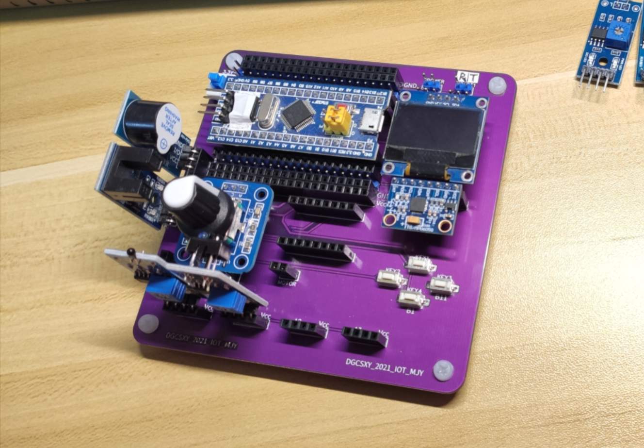

Teaching expansion board based on [Jiangxi Association of Science and Technology stm32]
According to the course source code of the stm32 tutorial of the Jiangxi Association of Science and Technology, the extended version is drawn. Each module can be inserted into the development board according to the tutorial for experimental learning. The advantage is that it is convenient for welding. You only need to weld the mother and pin headers, and you don’t need to weld the chip components. The bom table is inaccurate. When drawing, it is not strictly compared with the pin and mother headers. Some boms may be pin headers, but in fact they should be mother headers. There is no power supply module at present. The power supply needs to be connected to the 3v3 power supply through an external Dupont line. It is better to connect the 5v of the power supply together for more stability.
