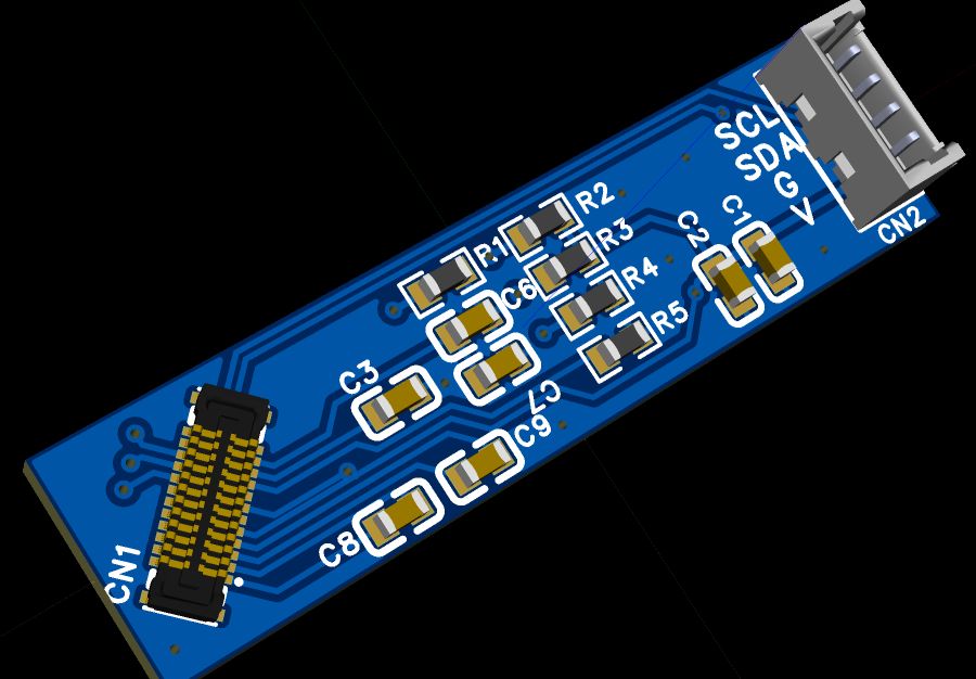

0.98 OLED
It is controlled by IIC. The RESET pin is not connected. (It has been modified to 4-wire SPI)
//20220224 has not been verified, and I am just
drawing it casually while making a board.
20220310
I did not read the manual carefully when using it for the first time. The communication mode selects BS0-BS2 that requires the chip. Pin control. This has been set in the screen and does not lead to relevant pins, so it is a fixed SPI4 line mode.
The microcontroller uses G030C8T6
