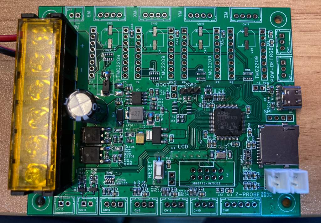

This project is a fork upstream project
The main modifications are as follows. At the same time, the wiring has been rearranged and changed to single-sided components.
  • Modify single-wire UART mode and incorporate exclusion
  • Modify SWD interface
  • Fixed USB-D+ pull-up control issue
  • Delete the WS2812 light and keep only the interface
  • Modify the DCDC part to save BOM costs
  • Delete the inverter in the MOS control part
  • Modify the interface to Type-C, CC defaults to the source output 5V
  • Modify power and heating interfaces
  • Modify the limit switch interface to 3pin
  • Modify the buzzer interface to disconnect the jumper cap
  • Adjust X, E0, display, I2C, PWM and other ios, use the software I2C interface to connect to EEPROM, and FAN0 is multiplexed with BEEPER
  • Separate CS from SD and external SPI devices
  • RESET adds a pull-up to avoid problems with some domestic compatible films
Test project (tested under klipper):
  • 12V and 20V power supply
  • Normal homing and printing
  • Normal heating and temperature control
  • Hardware PWM driven fan
  • TMC driver communication (only stepper motor drivers with UART address bit function such as TMC2209/2226 can be used)
  • Type-C external power supply and Orange Pie Zero2 one-line communication
  • Automatic shutdown module
  • Automatic leveling probe
  • ADXL345 and SD card

Photos of the actual object (space is limited and a bit messy)
