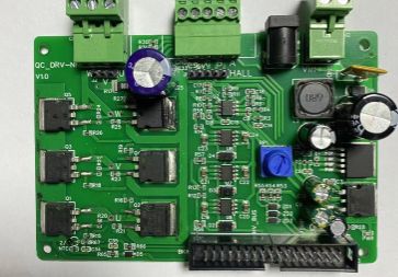

1. Introduction to brushless DC motor driver board/power board
Version: V1.0 (verified)
Voltage: 9~24V
Limit voltage: ~40V (haven’t tried it, but it can be done with good heat dissipation theory)
Current: 0~4A can still exceed 0. It is not necessary for learning, but it is not necessary;
Recommended power: Within 100W. With proper heat dissipation, it is estimated to reach 300W. I haven’t measured it carefully, but I can only draw from experience.
Main components: Both the upper and lower bridges use NMOS, without integrated MCU main control, using ST official standard motor interface, supporting inductive Hall, non-inductive square wave, FOC vector control, etc.
Attached: ST motor interface definition (picture)
The complete set of information + driver board + MCU main control board + motor is available on Taobao. If you don’t want to bother, you can buy finished products on Taobao, including the main control board with ST standard interface.
Commercial use without authorization from the author is prohibited.
Taobao link:
https://item.taobao.com/item.htm?spm=a213gs.success.result.1.65d67a86CuT6Qk&id=668129776715
2. Added details and improvements in version V2.0
Note: The current version of the open source data is V1.0. The data will be updated here after V2.0 is physically verified. It does not mean that there are any big problems with the V1.0 version. If you have any questions, please see the introduction in this section.
1. The two network pins ICIV and IBIS at the V1.0 version of LM358 are floating. ICIV and IBIS are the bus average current and the bus instantaneous current (AD value) respectively. In the V2.0 version, ICIV and IBIS will be connected to pins 15 and 17 of the motor interface respectively. Used to monitor the operating status of the motor.
2. Add the oscilloscope clamping point (design the GND pad near the GND of 7805).
3. Add a test point to the AD pin of the potentiometer RP1 next to the LM358.
4. Add multiple test points near the LM358 pins.
The function of adding test points:
a. It is convenient to detect whether the working status of the board is normal (currently V1.0 is normal)
b. It is convenient to use an oscilloscope to observe signal waveforms in various places during learning, or to measure relevant voltage and current values.
5. Add 1nF capacitor filtering to the Hall sensor interfaces HA, HB, and HC.
Reason: During the test, it was found that the modulated Hall signal waveform output by some brushless motors had slight problems (a problem with the motor).
To sum up, the improvement concept of 2.0 is the icing on the cake of version 1.0.
