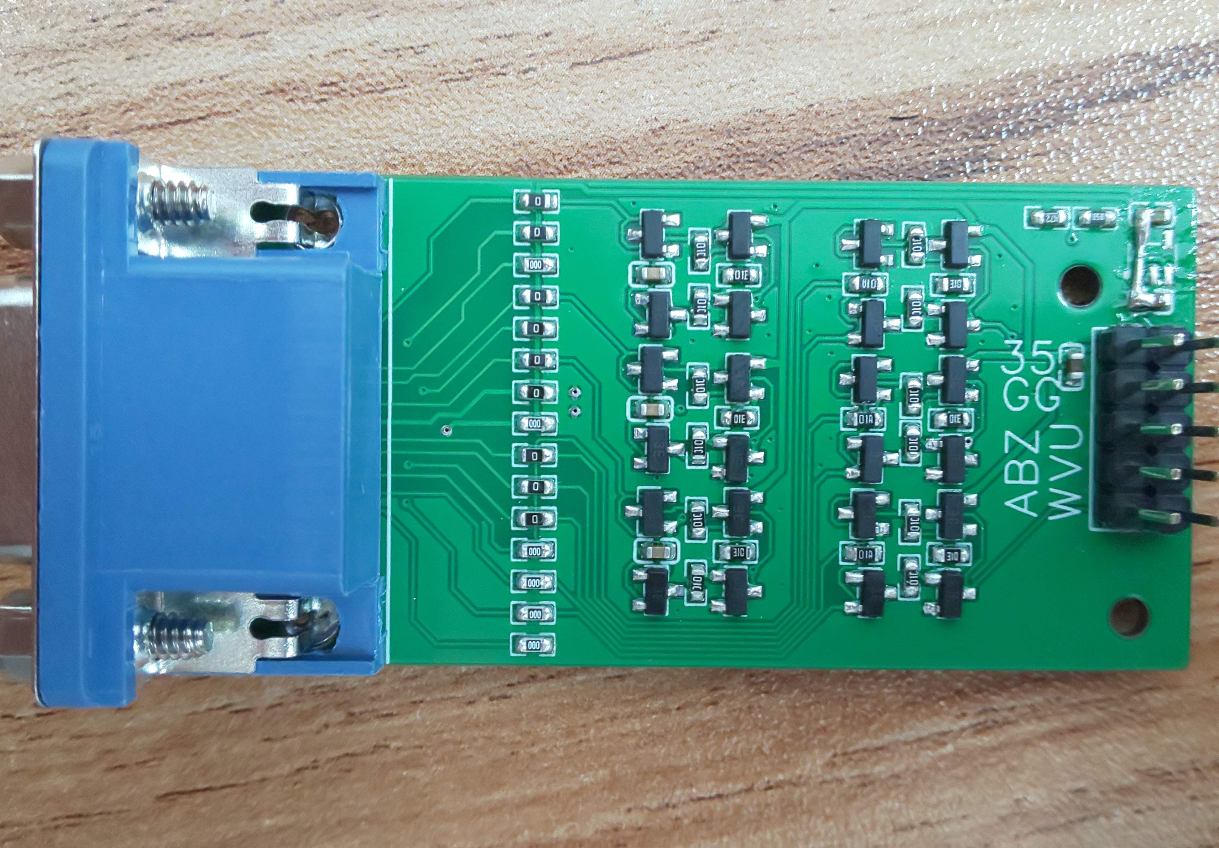

Only resistors and capacitors transistors are used to convert the motor's differential encoder signal (ABZ) into a single-ended signal and adapt to multiple levels.
After testing, the bandwidth is roughly between 500kHz and 1MHz. With slight modifications, it can be used to convert other differential digital signals below 500kHz to single-ended signals.
