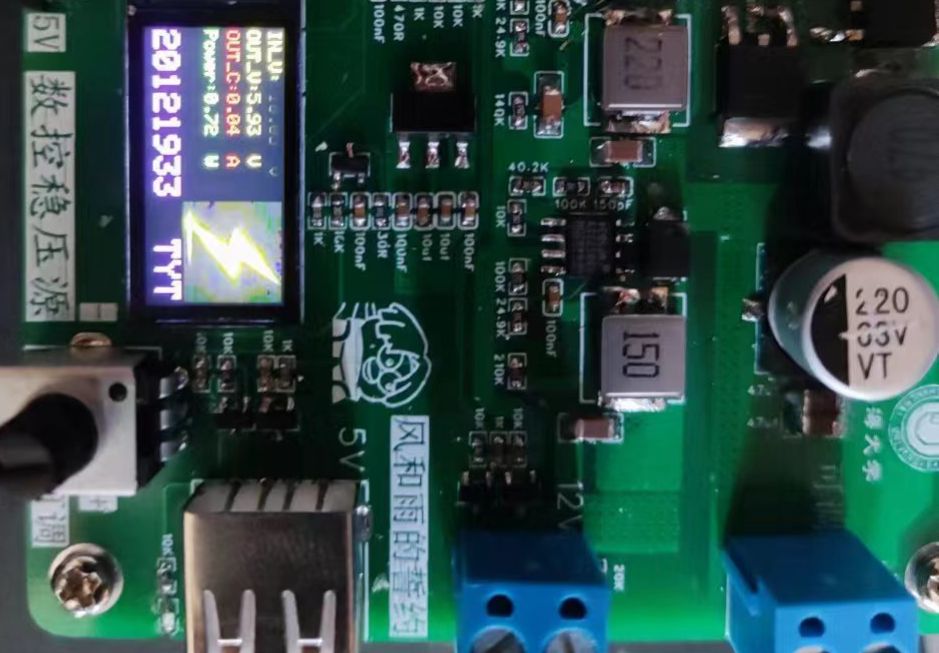

Multiple output regulated power supply
To convert 220V to a maximum of 36V, use a 30W transformer.
To convert a maximum of 36V to 12V, use the MP4462DCDC step-down chip
to stably output 12V
. To reduce 12V to 5V, use the MP1584DCDC step-down chip.
The adjustable output is a BUCK circuit, using STM32G030F6P6 to output complementary PWM control MOS tube
display module using esp8266 plus a 0.96-inch tft screen. Use virtual serial port communication with stm32.
Due to the short production time, the measurement data was not fitted, so the input current error was large. Voltage measurement is more accurate.
Due to limited capacity, we ask for your understanding. I hope you can correct me if there is something wrong.
