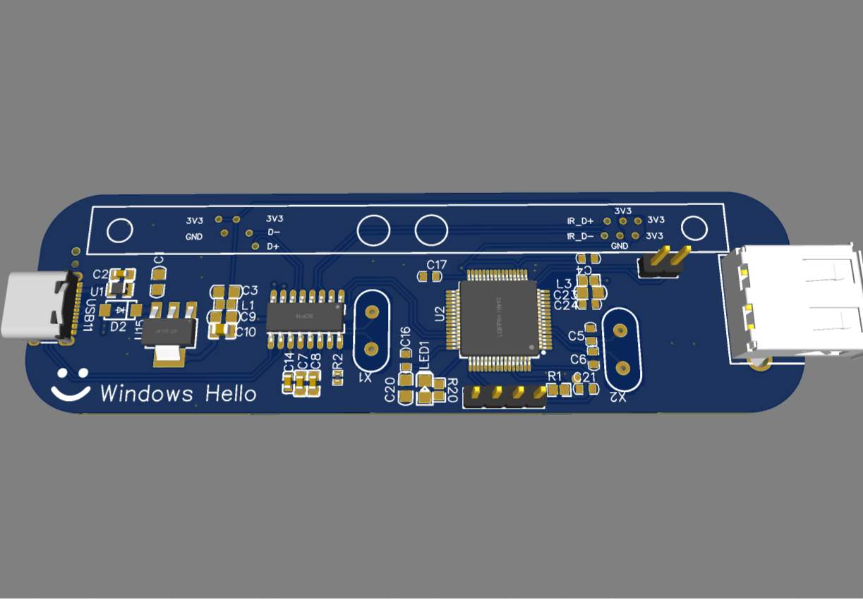

1, integrate SL2.1A on the PCB, realize USB one-to-four, realize RGB camera, infrared camera, audio data transmission on the module, and realize USB borrowing and returning at the same time 1.
2. The digital microphone PCM data on the module needs to be processed by the STM32F412RET6 chip DFSDM library and then transmitted through ST's Audio Device Class
参考设计图片
