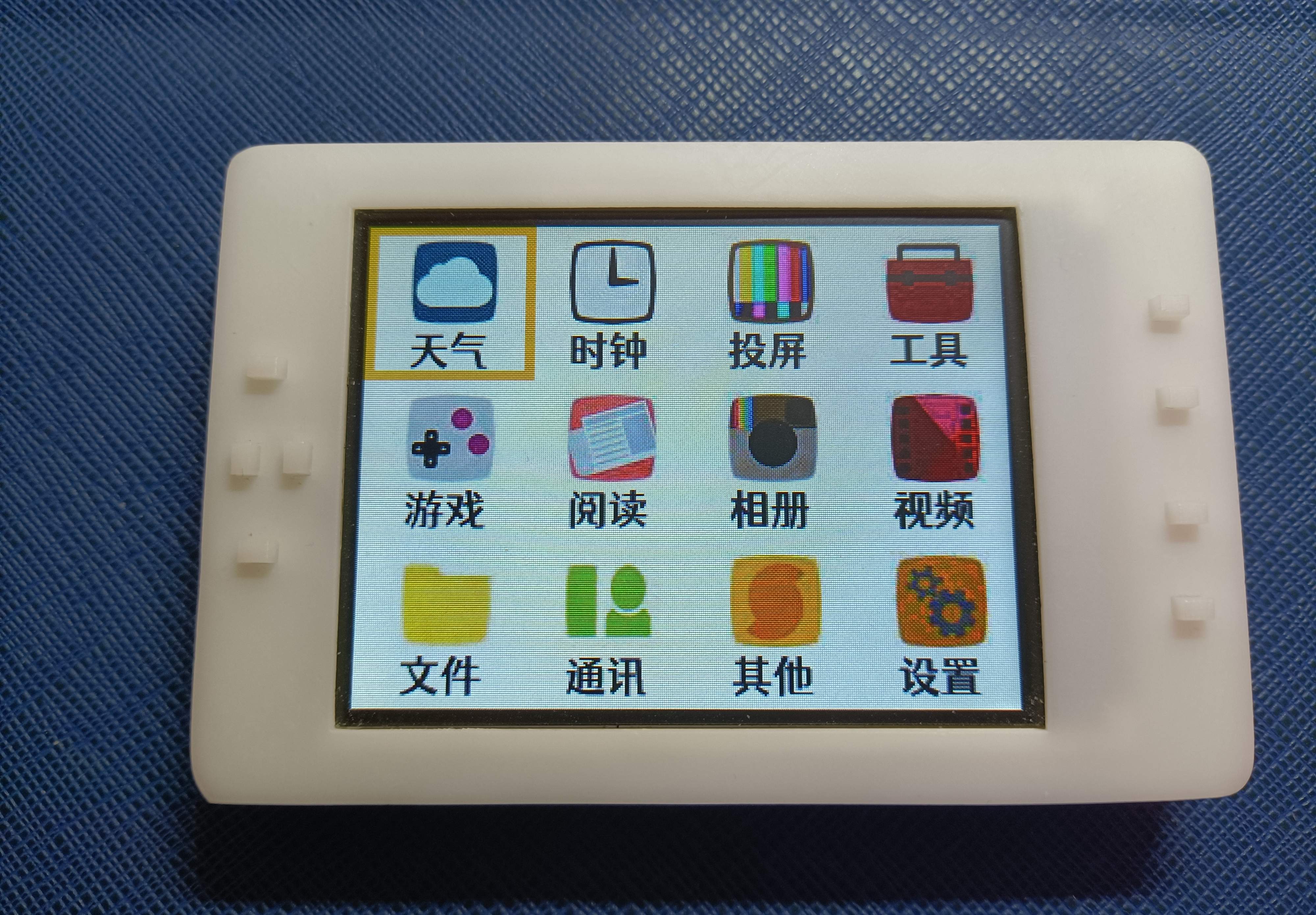

A multi-functional application card based on esp32 that supports clock weather, fan counter, alarm clock, countdown day, games, e-books, pictures, videos, news, stocks, offline mode and other functions.

1. The general logic of the system is: main menu-sub-function-sub-page
The main menu and submenu use yellow boxes to simulate the selected state. They can be moved through the four arrow keys. Press the confirm key to enter the function, and press the return key to return to the previous level.
For specific function button definitions, please refer to the document content.
2. Currently, 12 types of applications are preset, including:
Weather, clock, screen mirroring, tools, games, reading, photo albums, videos, files, communications, others, settings.
