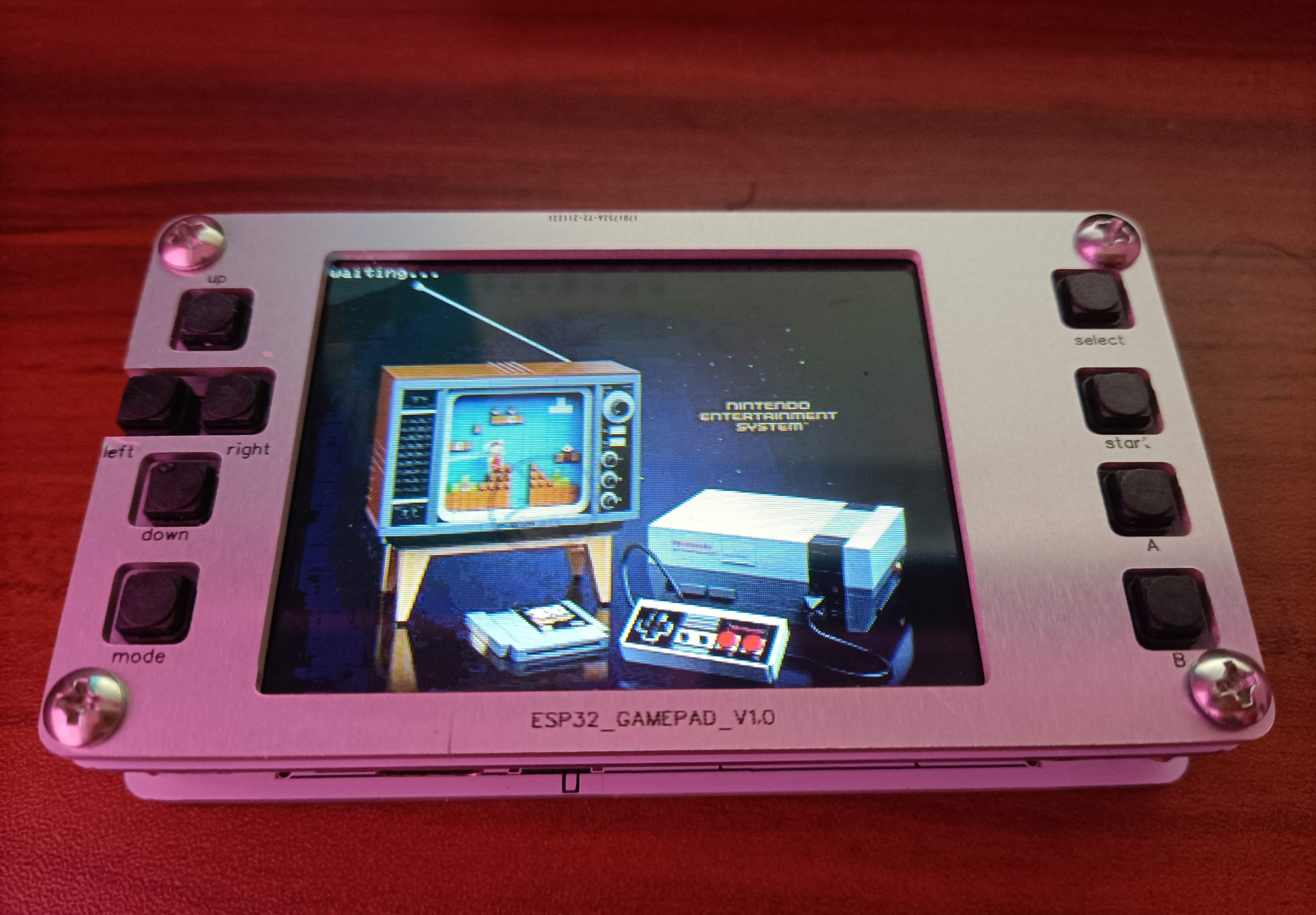

The open source NES game console based on esp32 is programmed with Arduino software, which is convenient for transplantation and DIY. The game files support large files (using psram technology). The game files are stored in the memory card. The number of games can be 999+, so you can fully enjoy the fun of the game.
At present, there are two esp32 game consoles in the Lichuang open source community. One can only be placed in the esp32 rom space and has a limited number of games. The other is espplay. espplay is very powerful, but the audio circuit is very complicated and the cost soars. In addition, this Both game consoles are written in IDF. Generally, you can only flash the bin file. It is difficult to transplant. After all, IDF installation and compilation are quite complicated, let alone modifying the source code. So I searched online and found this project, which is based on Arduino programming. The original project can only run the first game and cannot be selected. I modified it slightly to support selecting game files.

In fact, appcardv3 has been completed, but the buttons are a bit small and the feel is not very good. There is this new version, which includes a base board and panel.
1. Hardware part
1. PCB and welding
When pcb is printed, there is no thickness requirement for the substrate. It is best to use an aluminum substrate for the panel. In addition, it should be as thin as possible, 0.8-1mm is most suitable.
When welding, the buzzer pins with many pins need to be cut off, and there are no requirements for others.
2. Assembly
Use M3 screws, M3 two-way copper posts, M3 spacers,
M3 screws, and a length of 8mm or more.
M3 two-way copper posts are based on the thickness of your battery.
M3 gaskets, with a thickness of 0.5mm, are used to pad the front panel, base plate, back panel, and copper posts.
In the video, the gasket is not shown because it has not arrived yet.

(3) After powering on, the memory card is mounted normally and a picture is displayed, showing the "waiting" interface.
(4) In this interface, you can use the left and right buttons to adjust the brightness, which takes effect immediately. Left minus 10, right plus 10. The minimum brightness is 10 and the maximum is 255. It supports remembering the previous setting value after restarting. (For key definitions, please refer to the previous "4.appcardv3 Software Instructions for Use.pdf", the same below)
(5) In this interface, press the A key once to browse the root directory file. If it is not a game file, "Not a game file, please select again." will be displayed. You need to continue to press the A key to continue selecting until it appears. nes game files.
(6) After the .nes game file name appears, press the mode button to start the game.
(7) Follow up by following the key prompts in the game.
