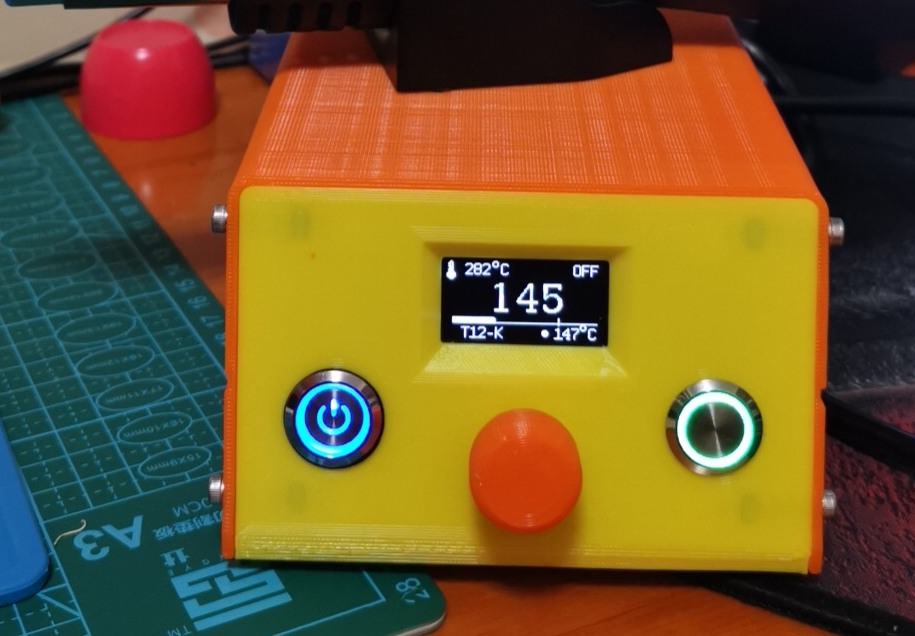

My product is divided into two boards: high voltage and low voltage. This link is the low voltage part. The high voltage part is as follows: https://oshwhub.com/red_bean/T12lao-tie-858Dre-feng-qiang-er-Hig Original reference address: https ://www.hackster.io/sfrwmaker/stm32-based-soldering-and-rework-station-e3955b My note: Updated on 2020/4/16: Updated the R1 R2 resistors. The original resistors match the hardware I am currently using. A little bit different. 1. Originally, I made a board for integrating high and low voltage and tested it and it works; 2. Later I separated high and low voltage. Now I will release the low voltage part first. The high voltage part is still under testing. I will release a project after the test is completed. And will post a link; 3. The original author provides OLED12C and ips screen options. In the current schematic diagram, I only use IPS wiring, and there is no 12C interface reserved; 4. There are two main switch parts on the front panel, the main It involves a 220 for the main switch and a 3-6V for the air gun switch; 5. In terms of wiring, XH2.54 is used for signal and low voltage, and VH-2P is used for high voltage control, which effectively ensures the safety of electrical appliances; 6. In terms of input, I did not use the solution provided by the original author. The bottom board uses a T12 soldering station power board, using 30MM long copper pillars for connection, and leaving about 5MM of space; 7. In the 5V transfer part I used the XL_2596_5V solution, and then isolated it through the isolation circuit of B0505S_1WR2, and it can be used after testing; 8. I reserved two signal interfaces on the P3 port on the motherboard, which can be used to add temperature-controlled fans later; this project has The following features: The controller allows simultaneous use of a hot air handle or soldering iron. The reed switch on the handle of the Hakko858D hot air handle is used to activate the rework function. The soldering iron can be automatically turned off or allowed to continue working according to the configuration parameters in the main menu.

Appreciation of finished product pictures: 5497f7e808cafd101f3539cafb53b17.jpg9c21d8153aeba47713367b09dcdbfd6.jpg05e437860301a84dea24efa14d9d7bc.jpg8cc948f0a025819385886ddbb481339.jpg production process and test pictures: b68530b3e49de4b9c5e19f0f41855ae.jpgQQ picture 20200326165715.jpgQQ picture 20200326165632.jpgfcf00b9df7176541ca193bec3e9ccb4.jpgQQ picture 20200326165732.jpge20baa8b5c16d72ffde1c8c4a6fec62.jpg
