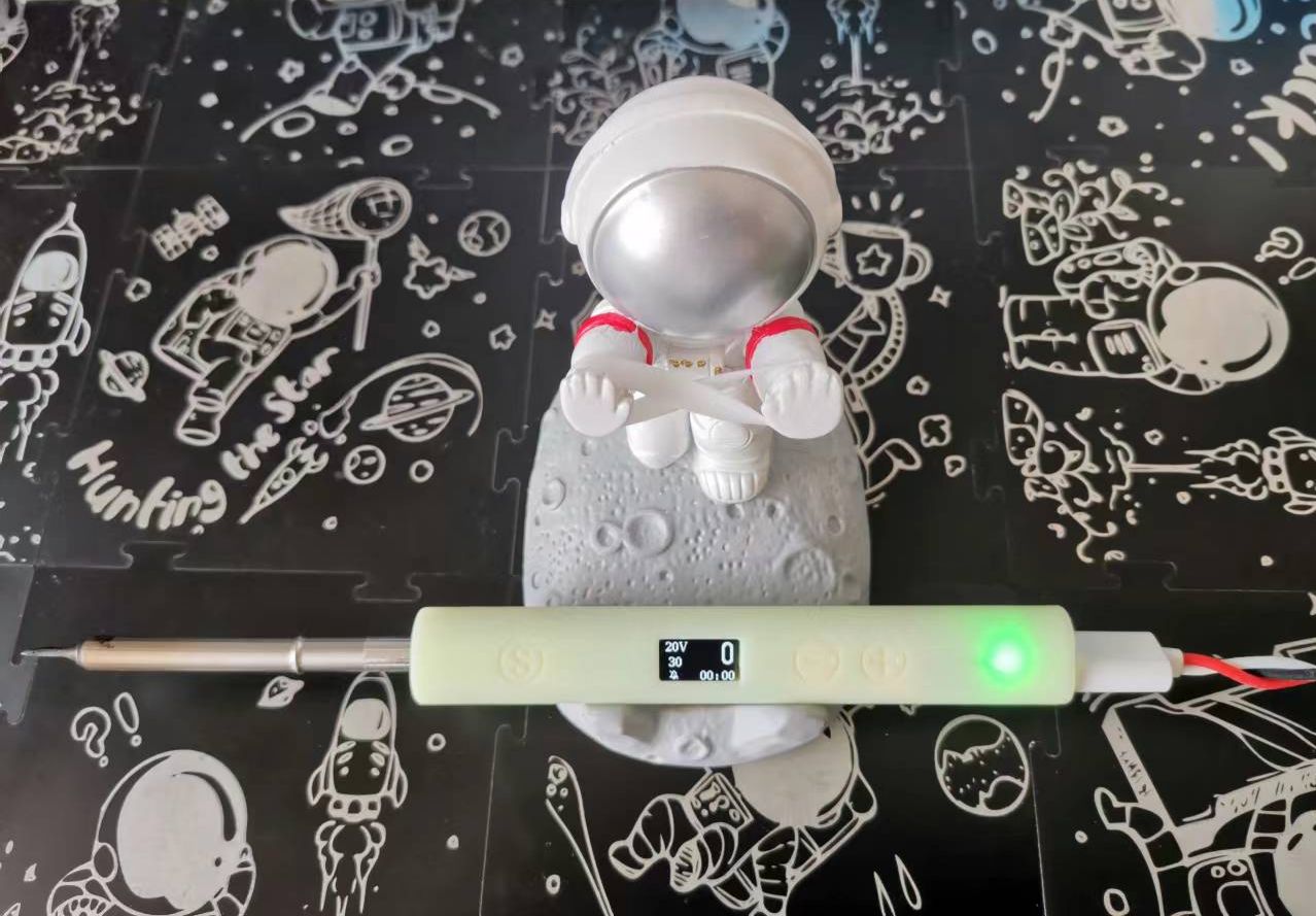

    First of all, I would like to apologize to the friends who made the last version of the board, because when I made this soldering iron, I just wanted to use the screen of Tun, and I did not expect to open source it, nor did I expect that after the open source mini heating table, my friends would become more Pay attention to my soldering pen, so I made a version with a 0.5-inch screen that is available on the market, so that interested friends can make their own soldering iron. Secondly, let’s talk about the original intention of making this electric soldering iron. I still remember that the first electric soldering iron I owned more than ten years ago was an external heating type that cost more than ten dollars. Later, I used an internal heating type. After using it for a long time, it became dull. When dipping tin, a handy tool is very important. I wonder how old it is. How come the electric soldering iron still looks like an electric soldering iron? Can't it be as portable as a pen? It happens to come into contact with the T12 soldering iron tip and the small-sized and high-power nitrogen soldering iron. For a gallium charger, if it has a hard core, it must be given a transparent casing so that each component can be clearly seen. This must be the favorite of every science and engineering man, and I am even more looking forward to the large-scale application of transparent PCBs. one day.
    Let’s look at some model pictures next.
   Finally, I highly recommend friends who like it to make one themselves. The cost will not exceed a hundred, and it is also commemorative. What you buy is a commodity after all. I am also very grateful to Jialichuang for the service support provided, from PCB design to From prototyping, component procurement, and 3D printing, I can achieve creative freedom in front of the computer.

You can solder the whole board first and then separate the board with a hook knife, but be careful not to cut the circuit. You can also separate the board first and then solder it individually. This method is recommended for novices . Weld the components of the front patch first, then weld the buzzer and female base on the back, then weld the spring piece, and finally weld the screen. When welding the screen, the FPC solder joints should be small.
After each board is powered on and tested correctly, perform three-dimensional welding of the triangular prism. First, insert the three boards into the auxiliary positioning block for positioning. Adjust the position. Weld the half hole at the tail first. It is best not to weld it firmly at once, leaving some The room for adjustment is like tightening multiple screws. Don't tighten one at a time. Apply a little tin first, and then add more tin to solder it firmly after the triangular prism structure is determined.

  • Shell making
The original design was to use a disposable glue package as the shell. The biggest advantage of this is that it is small in size and hard-core cool. However, it is troublesome to make. It requires a silicone mold and sealing. It takes several days to solidify and the success rate is also very low. Later, It also needs to be polished, and the touch buttons should be used under sealed conditions (this is also a pit). So I took a step back and tried to 3D print a detachable shell if it was not transparent. Although there are also transparent materials, I don’t recommend it for those who don’t have a printer (I asked one shop and it cost 100+). I first made a sample, made of white photosensitive resin, mainly to test whether the size would fit, as shown in the picture below.
Sure enough, the inner cavity is a bit big, but this is not a problem. Just make some modifications. Now that our school is closed, we don’t have a printer and the express delivery is super slow, so there is no opportunity for iterative modifications. I hope that friends with stereolithography printers around me can help. I verified it (see the attachment for the STL file). It is not recommended to use an FDM printer because it has a thin wall and a slender shaft structure. The hot bed attached to the bottom is not strong and the surface accuracy is not high, even though I increased the bottom attachment area. The shell printing model is shown in the picture below. It contains two parts, the shell and the shell cover. In order to increase the attachment area during printing, an auxiliary round plate is added to the shell. Just cut it off after printing is completed.
I also tried to place an order on 3D Monkey and chose URT6180 photosensitive resin and PA12 nylon as shown in the picture. I did not choose white because it was too ordinary.
