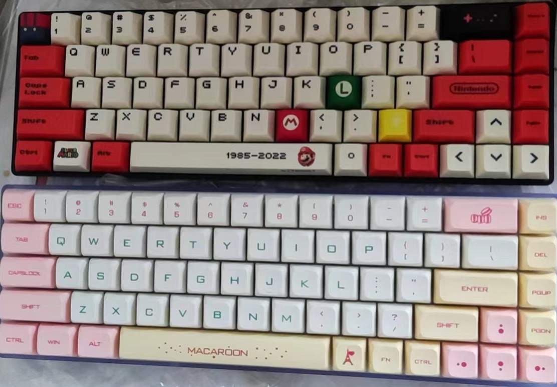

    • Installation and physical display:
      • The PCB opening does not perfectly match the CIY68. The screw holes are too large and spacers need to be added; holes need to be opened for USB and toggle switches; some components have slight interference; for the battery, the bottom case ribs need to be removed, etc.
      • Customized methods: bottom cotton filling, under-shaft pad filling, satellite shaft adjustment...
      • Finished product A: CIY68 black transparent kit + Jiadalong G yellow PRO + Mario keycaps image.png
      • Finished Product B: CIY68 Purple Transparent Kit + Phantom Transparent + Macaron Keycaps

    • RGB currently only has two effects: turning off lights and breathing;
    • In Bluetooth mode, there is a small probability of abnormal typing delay; in USB mode, it does not occur;
    • In terms of key conflict, it has not been optimized yet;
    • The V0.2 version PCB has not yet been proofed and verified. The RGB lamp bead power control circuit has been added from the V0.1 version (for the above two finished products, this part of the circuit is solved through flying wires) ;
    • The original file is in AD format and will be imported into LCEDA later. Please do not print directly ;
