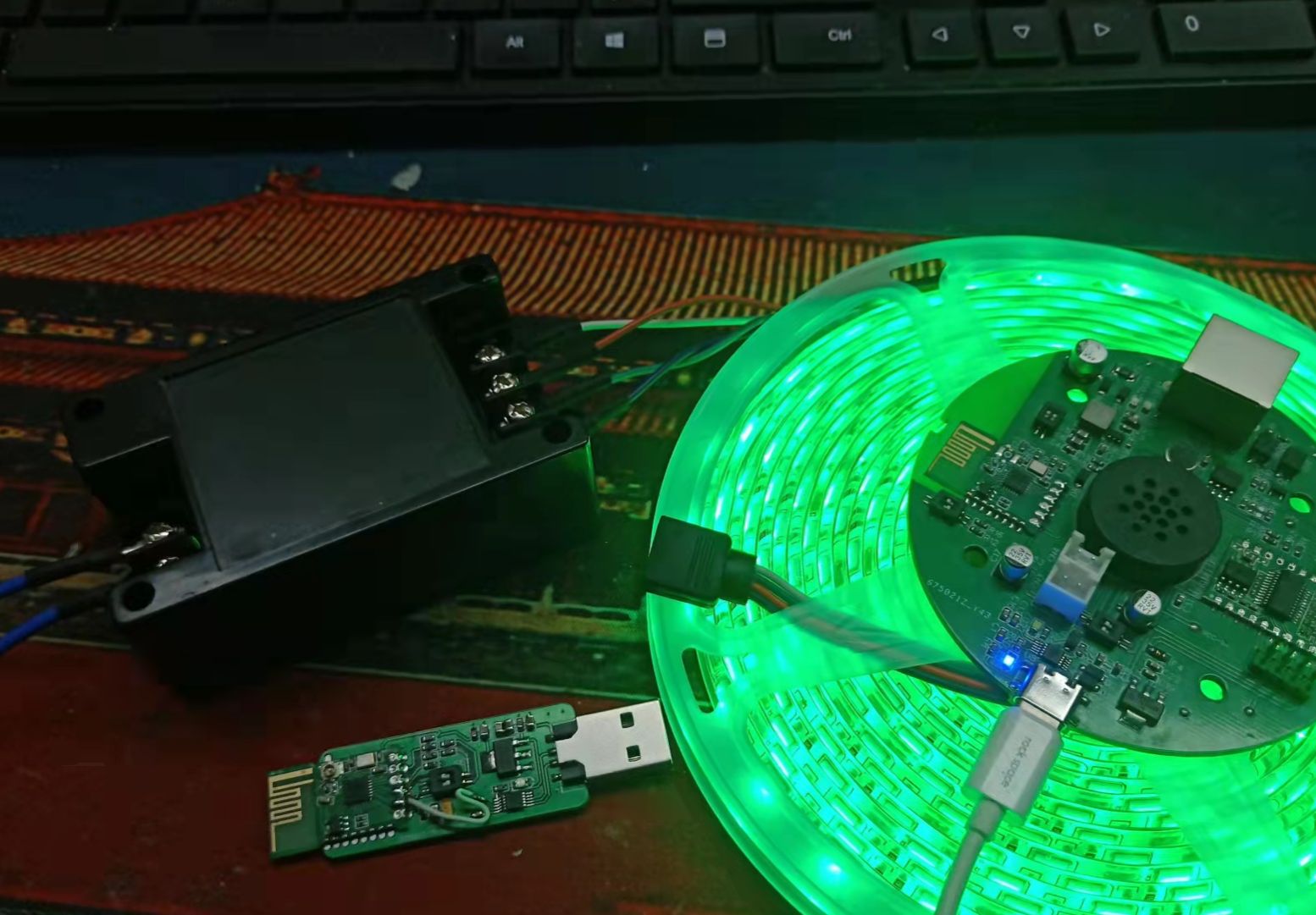

An optimization solution has been added to the original 485 light strip controller, and the voice control protocol and 2.4G wireless module are directly used to realize the remote control function. The private protocol is customized. The voice module adopts a market-ready solution, and both control entries and command entries can be used. There are three modes to change and control the light strip:
1; Monochrome always-on mode---red/orange/yellow/green/cyan/blue/purple/pink/white
2; Monochrome breathing mode---red/orange/yellow/green/cyan/blue/purple/pink/white
3; Color mode---1 color gradient---2 breathing gradient---3 color beating
4; Brightness--1%~100% adjustable (all)
5; Speed--1%~100% adjustable (monochrome breathing mode/color mode)
6; Baud rate--4800bps~115200bps
7; Module address: 0x00~0xFF (0XFF is a broadcast signal, all controllers will respond)
8; Memory function: disable and enable, remember the last parameters of the light strip;
9; Memory to turn on the light: memory to turn on and off the light strip;
I found a ready-made shell that costs 1.5 yuan, the control board costs less than 10 yuan, and the voice controller costs about 15 yuan;
There is still space in the film, and there is room for expansion. It can be regarded as a low-cost light strip control solution, open source board and burning hex file. The code is not open source. If you need the source code, please contact me.
