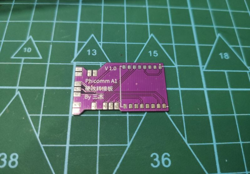

Projects for fun. Since the server has been gone for a long time, I changed to an ESP8266 to play. I've been working on it since 2020. I'm a procrastinator and it took me 2 years to finish it.
Using ESPHOME to build the firmware, the touch control function is temporarily missing and can be directly connected to HomeAssistant control. See attachment for configuration.
In addition, the accessory has a driver for the touch chip. If you are interested, you can adapt it.
参考设计图片
