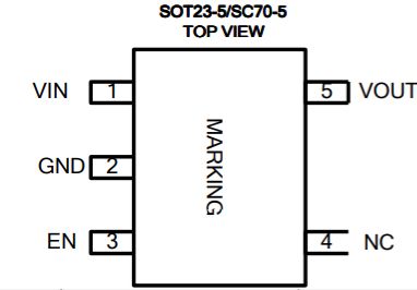

The BL9198 is designed for portable RF and
wireless applications with demanding performance and space requirements. The BL9198
performance is optimized for battery-powered
systems to deliver ultra low noise and low
quiescent current. Regulator ground current
increases only slightly in dropout, further
prolonging the battery life. The BL9198 also
works with low-ESR ceramic capacitors,
reducing the amount of board space
necessary for power applications, critical in
hand-held wireless devices. The BL9198
consumes less than 0.01µA in shutdown
mode and has fast turn-on time less than
50µs. The other features include ultra low
dropout voltage, high output accuracy,
current limiting protection, and high ripple
rejection ratio. Available in the 5-lead SC-70
and SOT-23 packages.
Ultra-low Noise for RF Application
Ultra-Fast Response in Line/Load
Transient
<0.01µA Standby Current When
Shutdown.
Low Dropout:210mV@300mA
Wide Operating Voltage Ranges:2V to
6V
TTL-logic-Controlled Shutdown Input
Low Temperature Coefficient
Current Limiting Protection
Thermal Shutdown Protection
Only 1µF Output Capacitor Required for
Stability
High Power Supply Rejection Ratio
Custom Voltage Available
Fast output discharge
Available in 5-Lead SOT-23 and SC-70
Package
