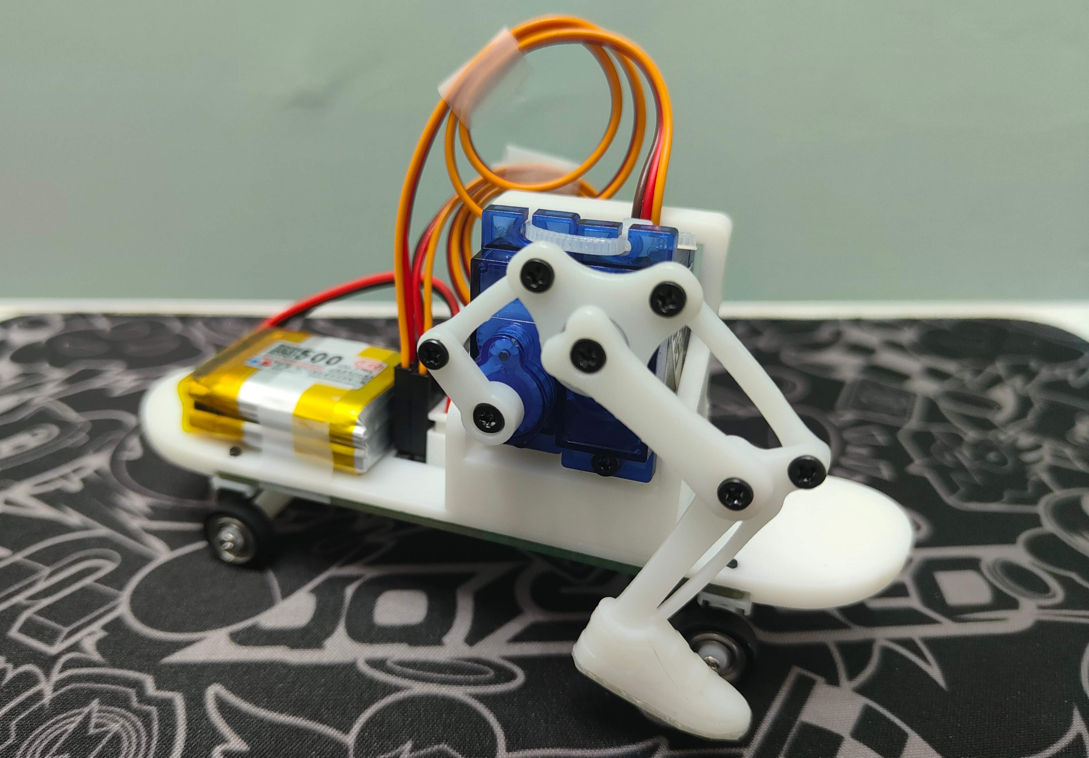

Even if you only have one leg, keep going! So I made him a skateboard.
In order for it to run, I couldn't drag the line, and at the same time, the control board didn't take up too much space, so I installed the board under the skateboard. Originally, I used M2.5*4 screws, but found that the installation was not firm, so I changed them to M2*6 screws, which protruded from the surface of the skateboard, but the screw specifications were still unified .
The small hole on the mounting shaft is used to expand the shaft diameter and prevent the bearing from slipping.
Legs based on human body bionic design
Reference picture (
The installation method can be seen in the picture below. The connecting rod with the steering gear has small teeth to prevent slipping.
Physical map
PCB
3D printing
The installation is complete
The servo on the left in the perspective of the picture below requires some effort to install. In fact, I originally wanted to use a direct insertion method to step on the skateboard with one foot and use the other foot to slide forward. However, considering the center of gravity, it was changed to this, resulting in the current position of the power interface being a bit awkward.
The two servos can be fixed with cable ties to reduce shaking. I put rubber patches on the soles to prevent my feet from slipping.
Precautions
7.4vPlease pay attention to the positive and negative poles of the power supply.
There is a problem with the reset button, do not solder it. You can use tweezers to short-circuit or use a two-pin button.
