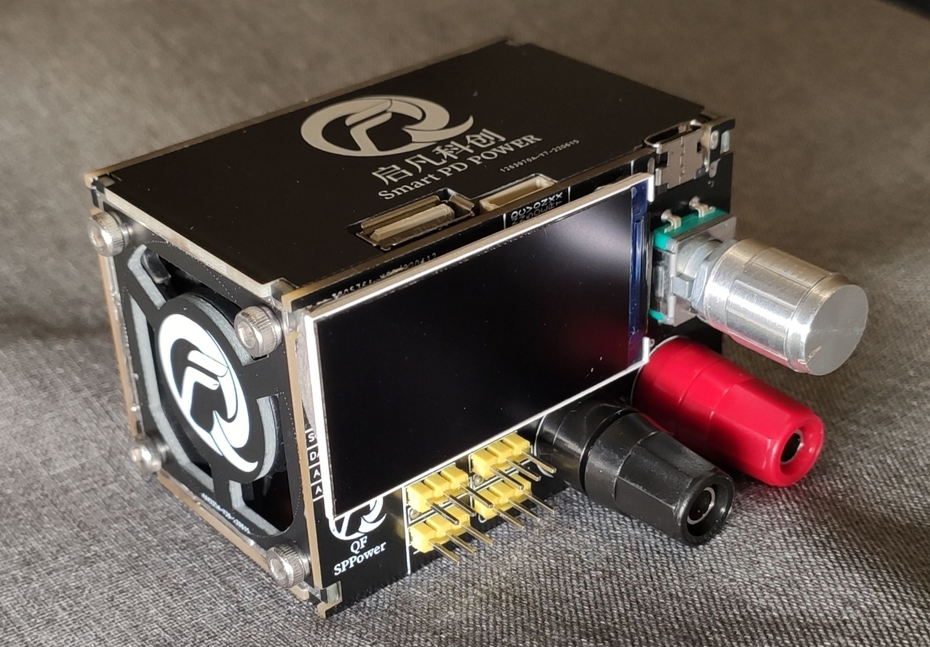

During the current testing process, it was found that SC8701 has a current problem in boost mode, causing the current reading to be unstable.
7.14 Update the modified power board and re-install the power board by yourself
Assembly demonstration video: https://www.bilibili.com/video/BV1xN4y1j7Hq?spm_id_from=333.337.search-card.all.click
Cooling fan specification: 4010 5V
Output binding post: Banana binding post M4*36 dual-purpose binding post
Screen: ST7789 1.9 inch 170*320
Officially designated program downloader open source link: https://oshwhub.com/dhx233/qf-euart
Qifan Science and Technology Open Source Official Q Group: 216066270
Project firmware continues to be updated
7-21 Log: Provide test DEMO, you can see whether your welding is correct
Fixed output:
Pin header interface:
1:+5V2A
2:-5V2A
3: Low ripple +3.3V1A
USB-A, USB-C interface:
+5V2A
Note: The above fixed output has a total power of 15W, please do not exceed this total when used together.
Adjustable power parameters:
Voltage range: 0-24V continuously adjustable
Current range: 0-5A continuously adjustable
Voltage resolution: initially set at 10uV
Current resolution: initially set at 1uA
Voltage adjustment step: initially set at 1mV
Current adjustment step: initially set at 10mA
