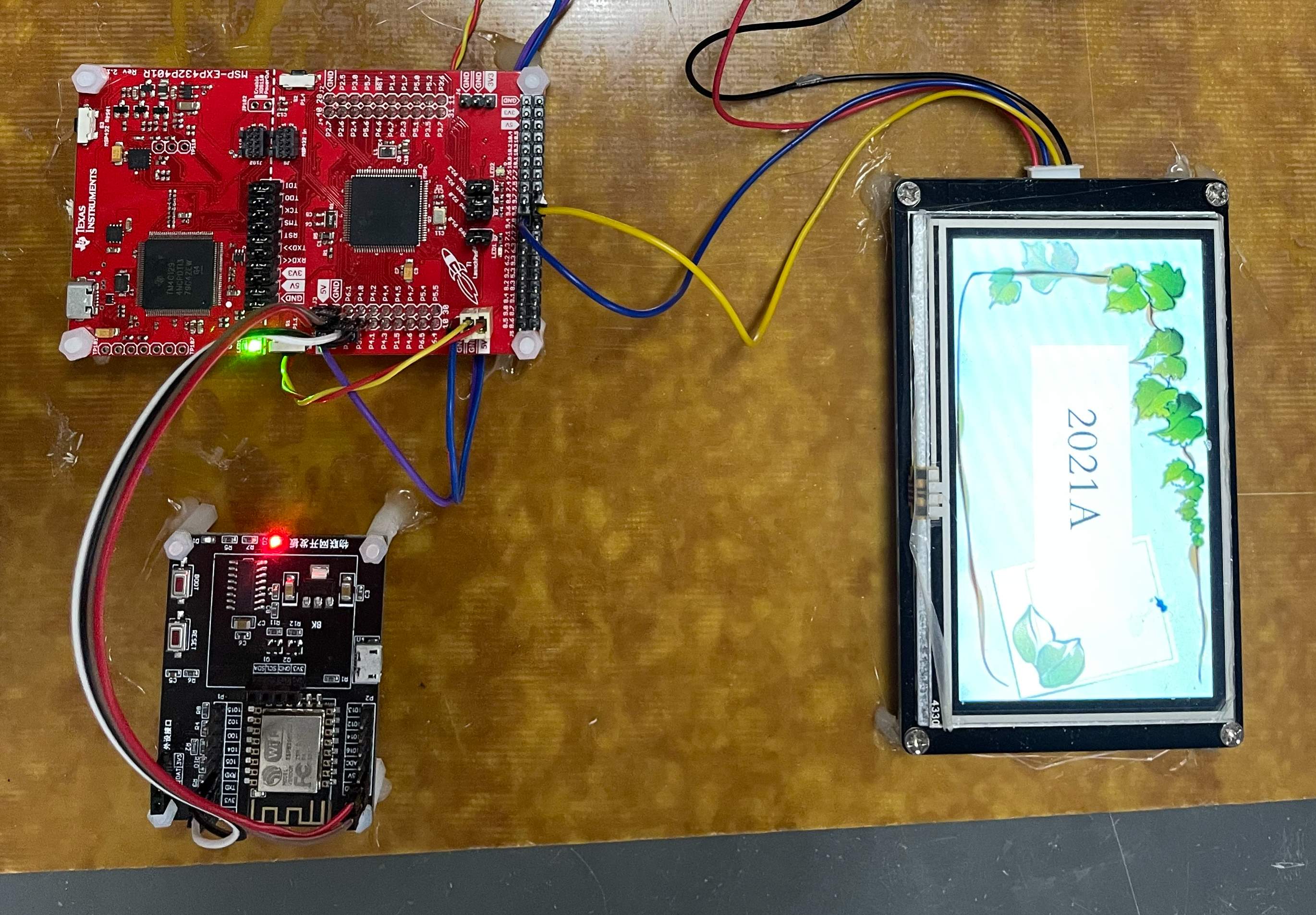

7. Physical display

Connect the signal to the AGC circuit, and after passing through the conditioning circuit, sample the ADC interface. The serial port screen is connected with Dupont cable, and the wifi module is connected with the microcontroller.
