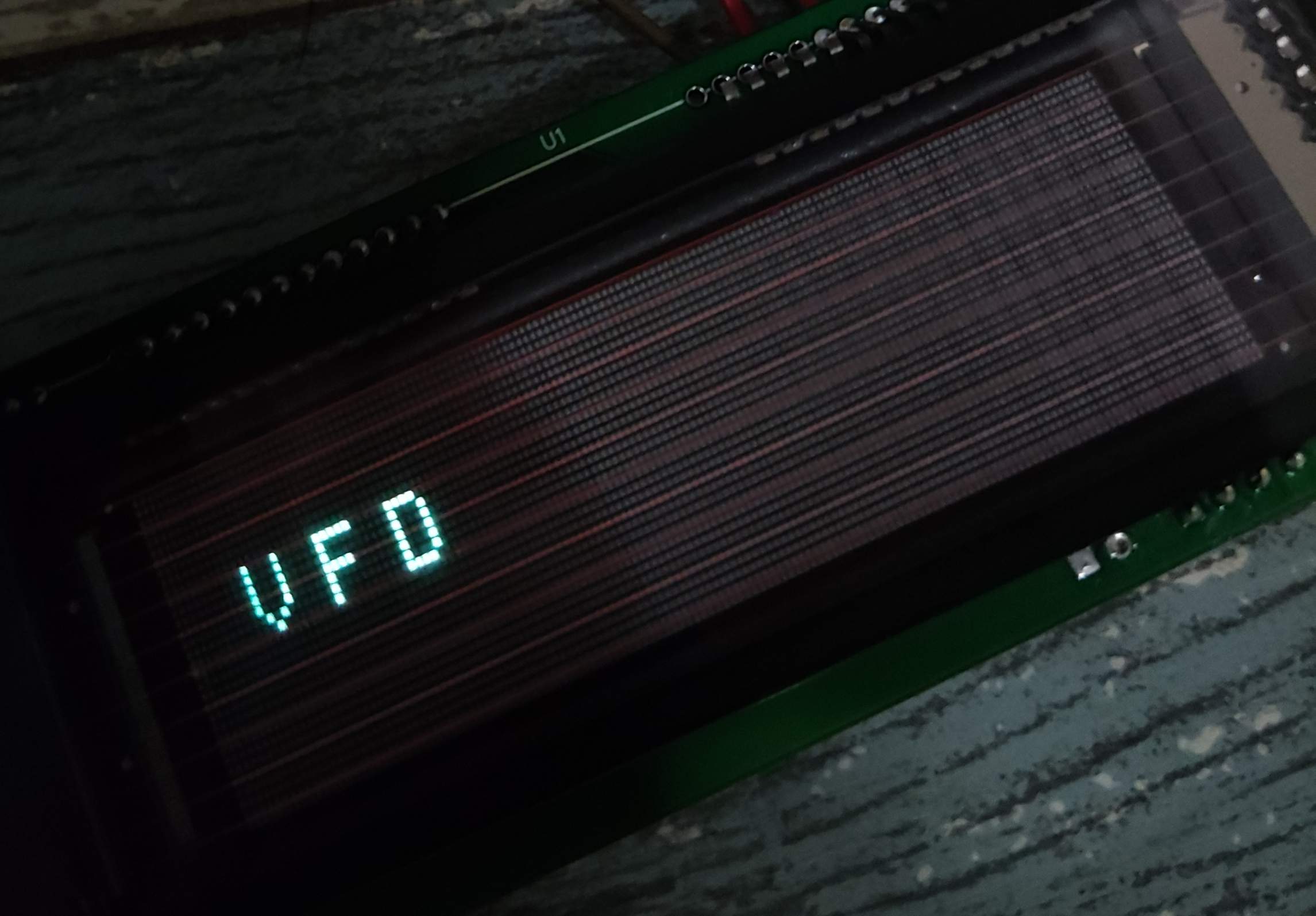

Driver chip:
       The model is futaba's gp1250ai
       The corresponding module is NAGP1250AA1
       The bare screen is three large 595, two anodes 128bit, and the gate 64bit
Voltage:
       Logic 5v
       Medium voltage 44v
       High voltage 60v
       (Measured on the Laowu baseboard)
      [+] 2021/4/25 21:13 Supplementary resistance (measured value) not marked on the board:
                Medium voltage: R7= 19.53K, R5 = 430.2K, R6 = 13.3K
                High voltage: R8 = 12.4K, R10 = 633.7K, R9 = 13.24K
Boost:
       I made reference to the bottom plate of Lao Wu.
       (I wonder if the dcdc can be replaced with a cheaper one, the current one costs 7 yuan a piece)
Driving logic:
        SIN: serial data input
       CLK: clock, low level write
       LAT: output latch
       BLK: output enable
       Gxxx:Gate
       _xxx: Another set of anodes
driver:
       Still writing......
[+] 2021/4/24 21:05 The driver is written (although it is a bit inhumane)
       Attachment:/stc: Scan the code of the microcontroller
               /FTBDATA: esp32 aduino test code, graphics based on Adafruit_GFX
       Usage: esp32 can configure Serial1 (9600,8N1)
                Other microcontrollers can rewrite the VFDsend function
[+] 2021/5/13 13:43 The V2 driver is written (ftbtestV21)
project:
       sch is the schematic diagram of 2.0
       2.0 PCB is being prototyped and tested
       The remaining one is the package pictured on the cover that has been adjusted, but the circuit has not been changed (when I came back from the board, I found that the package was wrong...)
       [+] 2021/4/24 21:05 The driver is for the pcb "PCB_[Experimental][Unverified]vfdFTB"
Known issues:
      Driver code: The leftmost 2 pixels and the rightmost 2 pixels cannot be displayed
