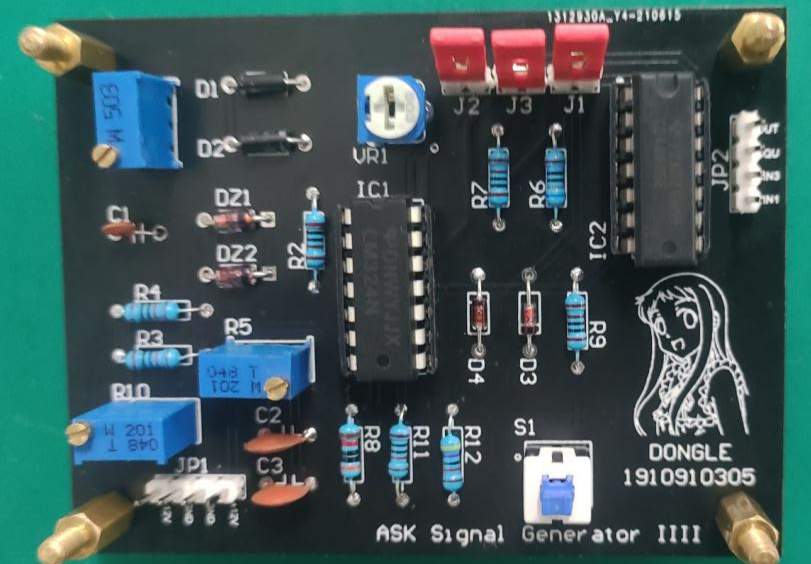

Attachment 1: Physical photo of the circuit
Attached Figure 1 Front view of circuit board
Attached Figure 2 Reverse view of the circuit board
