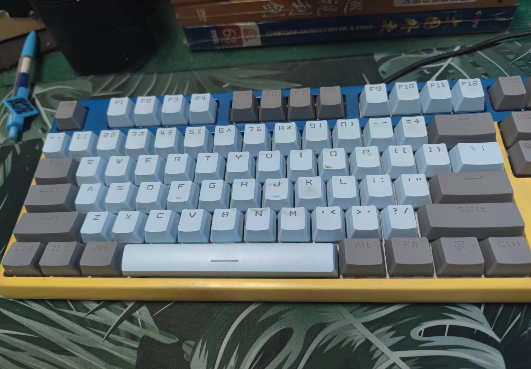

QMK (supports VIA) 980 configuration keyboard developed based on ATMega32A
[Advantages] 1. The keyboard PCB can be replaced with a variety of different main controls;
2. The 6ROW+18COL keyboard combination is convenient for most people to use;
3. The QMK system can be customized to use your own imagination.
[Features] 1. Kaihua hot-swappable shaft seat design is used to facilitate the replacement of the shaft body (the pins of the shaft body are soldering pads. It is designed as a five-pin shaft and can be directly welded [for players without positioning boards]);
2. It uses 2812 lamp beads and cooperates with QMK to have rich RGB special effects;
3. Support VIA software.
[Attachment] The attachments include the BL of ATMega32A, the QMK source code of this keyboard (one does not support VIA, and the other supports VIA, please pay attention to distinguish), the sandwich stack shell file of this keyboard, BL and code programming tools, QMK develops the software required. (Links are provided for download, all relevant resources are there, see below)
