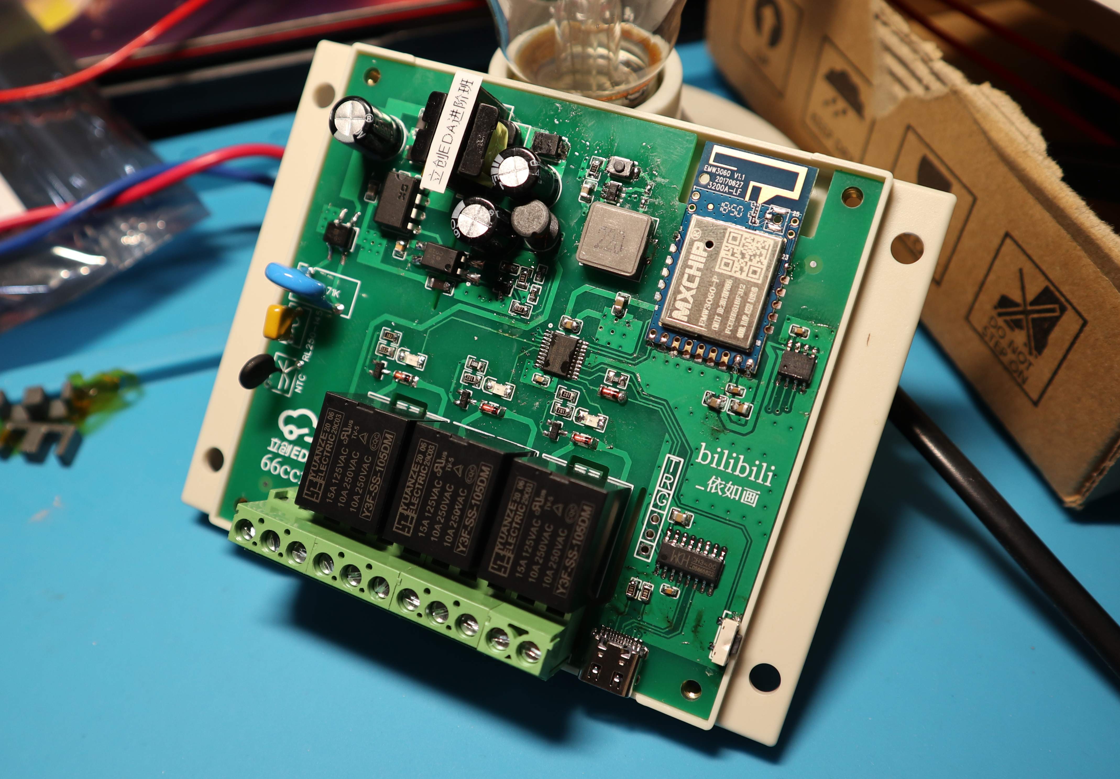

The board has arrived
Comparing the BOM and silk screen, there are some materials in the welding part.BOM table and bit number.jpgPartial welding.jpg

Welded out the hardware last night
partial error
The internal resistance of the 1mH inductor is too large and the rated current is too small. As a result, the front of the inductor is 5V and the back of the inductor is about 4V (0.2A load). The short circuit needs to be solved by removing the wires and rewinding. Grinding the air gap on the transformer doesn't work, just replace the core paper and open the air gap.
5V power supply test (the voltages in this article were measured by a multimeter purchased at Lichuang Mall at your own expense)
During the test phase, light bulbs are connected in series. If possible, an isolation transformer, autotransformer, or oscilloscope can be used to make the measurement more accurate and safer. No-load 5.01V, 1.3A loaded, 4.96V, load regulation rate 1.01%, loaded for a period of time, Basically not hot (can touch it) 5V1.3A with load.jpg
3.3V power supply test
No-load 3.285V, chip rated 1.2A, loaded 3.244V, load regulation rate 1.26%, light touch switch enable has effect 3.3V1.2A loaded.jpg
The power supply is normal and everything is welded. It can be seen that the space utilization rate is not high. . Heat dissipation is basically no problem.
Install the case to test the USB-TTL circuit
Double-head typec, the mobile phone recognizes CH340C, and the hardware is successful. Finished product.jpgserial port.jpg
hardware test

The program was written until 2 o'clock in the morning. The hardware can be operated independently, but there are a lot of bugs when splicing it together. The company held a team building in Fenghuang Ancient City on 14-16. I didn't bring my computer, so the program is probably out of date.
--------------------------------2020/08/17------------- -------------------------------------------------- -------------------
When I came back last night, I wrote from 19 to 2 a.m., and I was able to achieve basic operations: reporting the temperature to the cloud every minute, and controlling the three-way relay switch with my mobile phone.
! The serial port sending crashed. Finally, it was found that the serial port interrupt needed to be turned off when the serial port was sending. The interrupt conflicted with the query.
I wrote the configuration network at night and controlled it with the cloud public version APP, but failed to connect to Tmall Elf (the identifier did not use the socket routine)
Optimized the serial port reception and transmission. Previously, the reception would fail to receive the instructions issued by the cloud. Now it can be received as long as there are no multiple operations within 1 second. The triplet is still burned in by default (it is not transferred and burned through the serial port).
