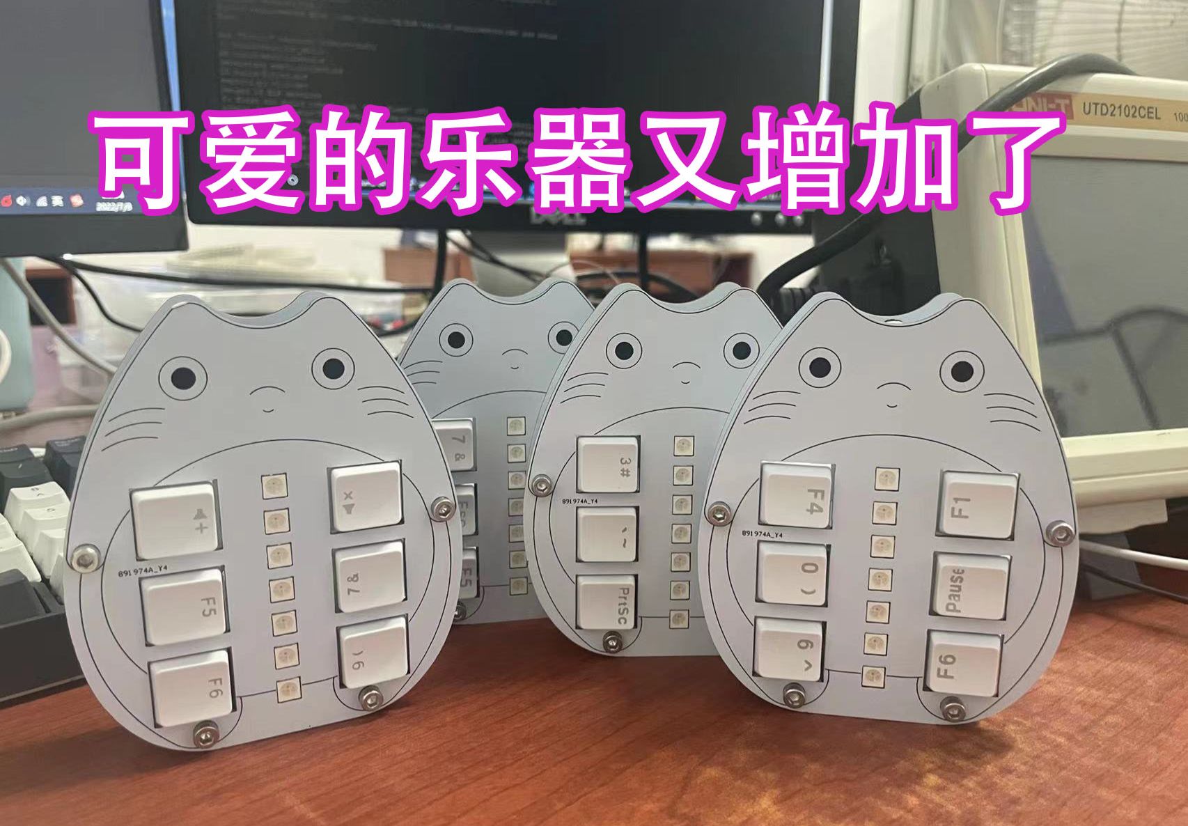

This product is an electronic musical instrument. The main control chip uses ESP32. Its appearance imitates the shape of the ancient Chinese musical instrument "Xun". It has six buttons, simulating the six finger holes of the instrument, and can play 13 tones. Through the Bluetooth MIDI protocol, connect the mobile phone "Zileban" APP and make sounds on the mobile phone ~

Its working principle is that the microphone detects the size of the blowing airflow, converts it into voltage, collects it through the ADC, and controls the volume. Different key combinations identify different notes. Bluetooth is responsible for sending note and volume information to the mobile phone and making sounds on the mobile phone.
The microphone is installed as shown in the picture above. When playing, blow into the kitten’s ears.
The specific fingering is as shown in the picture above, and a total of 13 notes can be played.
The board is equipped with 7 WS2812 lamp beads to indicate the Bluetooth connection status and airflow intensity.
The hardware structure adopts the form of upper and lower floors, connected by 4 copper pillars in the middle. The copper pillars also have 4 electrodes for communicating with the upper and lower floors.
The size of the board is controlled within 10*10, and you can go to Jialichuang for free proofing~~~
